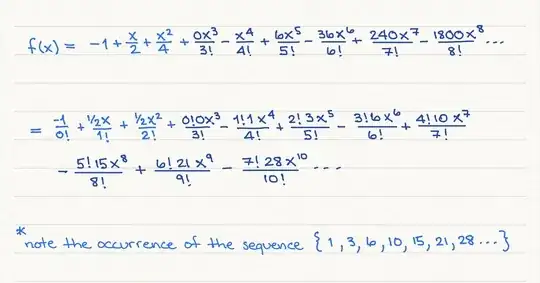

I have highlighted the terms of this series which settle into a regular pattern. The first few terms do not follow the pattern, perhaps because the factorial in the numerator would have to take a negative argument, and the other sequence which occurs (readily identifiable as the third diagonal in Pascal’s triangle) would lie “outside of” Pascal’s triangle for the first three terms.
Should I perhaps split the first three terms into g(x), and treat the remainder of the series (in dark blue) as a separate function h(x), ie, f(x) = g(x) + h(x)?
Are there any suggestions for extracting a function for this series? the series
the motivation

  • Yes, so should I analyze the sequence from the 4th term separately, and treat the first three terms as a quadratic which is added to the function? I’m wondering if this sequence can be expressed as a finite composition of elementary functions. – Christopher Emery Dec 14 '21 at 23:30

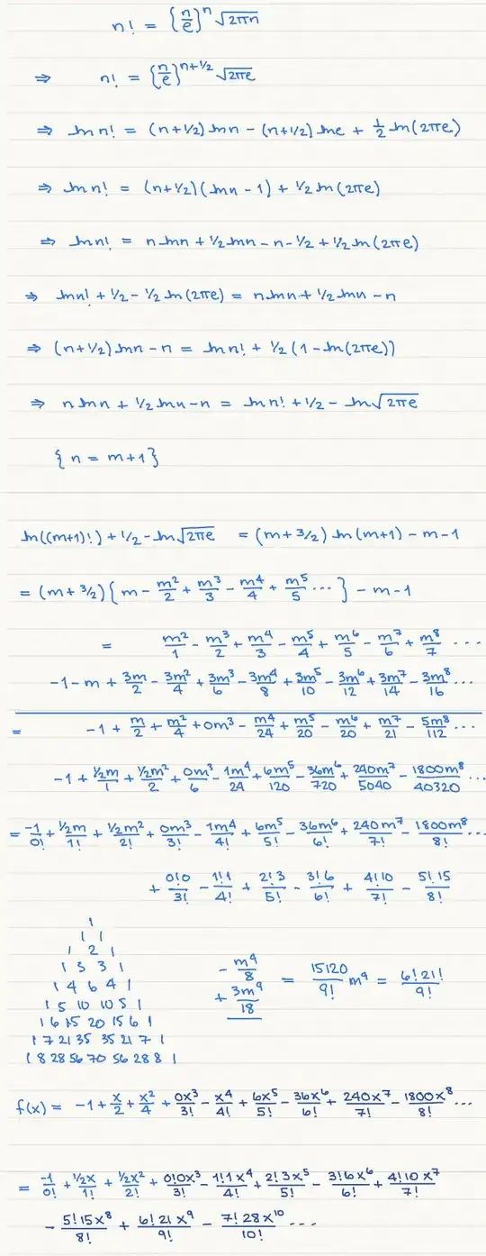

  • Well, I used the substitution n = x+1 in ln(n), hoping to deal with the shift later. Can I show you how I arrived at the sequence? I don’t know how to code the notation, but I can screenshot the page and post it. – Christopher Emery Dec 14 '21 at 23:35

  • Note : reading your edited post during my redaction of this answer, it seems you searching for an inverse of the factorial ? If so look at this answer by robjohn --> https://math.stackexchange.com/a/2079043/399263 – zwim Dec 15 '21 at 00:51
  • Yes, precisely. But more precisely, I thought to examine the problem by way of power series, although it is universally accepted that no such closed form inverse exists. I can easily derive an inverse in terms of the Lambert W function, but then we’re right back to using numerical methods to evaluate the result. Thank you for your comprehensive, detailed solution nevertheless. – Christopher Emery Dec 15 '21 at 01:47
