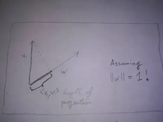

3. Projections
For the dot product on $\mathbb R^n$, we know that $\langle v, e_i \rangle$ gives the $i$-th coordinate of $v$. Or, we can describe the projection of $v$ to the $i$-th coordinate as the vector pointing in direction $e_i$ with length $\langle v, e_i \rangle$.
Now the final core idea of inner products is to vastly generalize this to:
If $w$ is a vector of length 1, then $\langle v, w \rangle$ is the length of the projection of $v$ onto (the line through) $w$.
Which, if vectors are visualized as arrows, should make you see this picture:
And after the lengths motivated property 4, and angles motivated property 3, this projection business should motivate the first two properties, as it is quite clear that
  • the projection of a scaled vector is just scaled accordingly, $\langle av, w\rangle = a\langle v, w\rangle$, and
  • the projection of a sum is the sum of the projections: $\langle v_1+v_2, w \rangle =\langle v_1, w \rangle + \langle v_2, w\rangle$.
NB: For this we assumed that $w$ has length $1$. Keeping such $w$ fixed, we then stretch $v$ to see that its projection on $w$ stretches with the same factor. But what if instead we stretch the other vector $w$? The projection of $v$ on $w$ is of the same length as the projection of $v$ on $aw$ for any $a \neq 0$. It is a nice little exercise to infer from this that for a vector $w$ of general positive length, the projection of $v$ on $w$ has length $\dfrac{\langle v,w \rangle}{\langle w,w \rangle}$.
