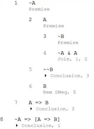

In daily discourse, if we know that a proposition is false, we don't usually give much thought to its implications. In mathematical proofs, however, if a proposition $A$ is assumed or proven to be false, we can infer that $A$ implies $B$, no matter what the truth value of $B$ may be. Symbolically, we can state this so-called principle of vacuous truth as
$$\neg A \implies [A \implies B]$$
As a kind logical "firewall," we would not be able to infer anything about the truth value of $B$ from this statement since $A$ is assumed to be false. In this case, more information would be required to infer anything about the truth value of $B$.
This principle can be derived by other more basic rules of logic as follows using a form of natural deduction (screenshot from my proof checker):
If the principle of vacuous truth is somehow be disallowed, one or more these basic rules of logic must be eliminated or otherwise restricted in their application. The "cure" would probably be worse than "disease" IMHO. There would be little to gain.
