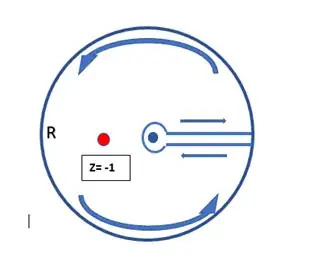

If we want to use the complex integration to evaluate $I(m,k)$, we can integrate along the keyhole contour with the cut $[0;\infty]$:
Let's denote $a=\frac{m+1}{k}-1\,\, (a<0)$, then $$\frac{1}{k}\oint\frac{z^a}{1+z}dz=I(m,k)-e^{2\pi ia}I(m,k)=2\pi iRes_{z=e^{\pi i}}\frac{1}{k}\frac{z^a}{1+z}$$ $$I(m,k)=-\frac{\pi}{k}\frac{1}{\sin \pi a}=\frac{\pi}{k}\,\frac{1}{\sin\frac{\pi(m+1)}{k}}$$
