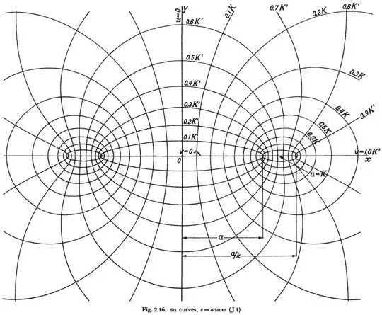

Confocal quartics as an example:
$$\frac{(x^2+y^2-1)^2}{c-s}+\frac{4x^2}{a-s}+\frac{4y^2}{b-s}=0$$
with foci $z\in \mathbb{C}$ obeying
$$z^4-\frac{2(a+b-2c)}{a-b}z^2+1=0$$
In particular, the two orthogonal families of curves namely
$$(x^2+y^2-1)^2- \frac{(\operatorname{ns} u - k\operatorname{sn} u)^2}{k} x^2+ \frac{(\operatorname{dc} u + k\operatorname{cd} u)^2}{k}y^2 = 0$$
and
$$(x^2+y^2-1)^2- \frac{(\operatorname{dn} v' - k\operatorname{nd} v')^2}{k} x^2- \frac{(\operatorname{cs} v' - k\operatorname{sc} v')^2}{k} y^2=0$$
are presenting conformal mapping of Jacobi elliptic function
$$z=\operatorname{sn} (u+vi,k)$$
where $k$ is the modulus, $k'=\sqrt{1-k^2}$, $\operatorname{dn} v'\equiv \operatorname{dn} (v,k')$, etc.
