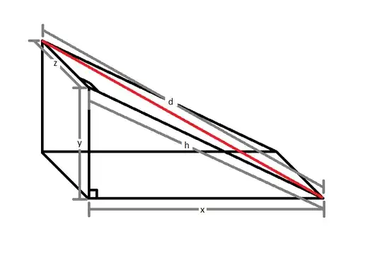

Here is an illustration:
3d Pythagorean theorem illustration
You want to find $d$, where $d^2 = h^2 + z^2$, and $h^2 = x^2 + y^2$. So
$d^2 = (x^2 + y^2) + z^2$, and therefore $d = \sqrt{x^2 + y^2 + z^2}$
