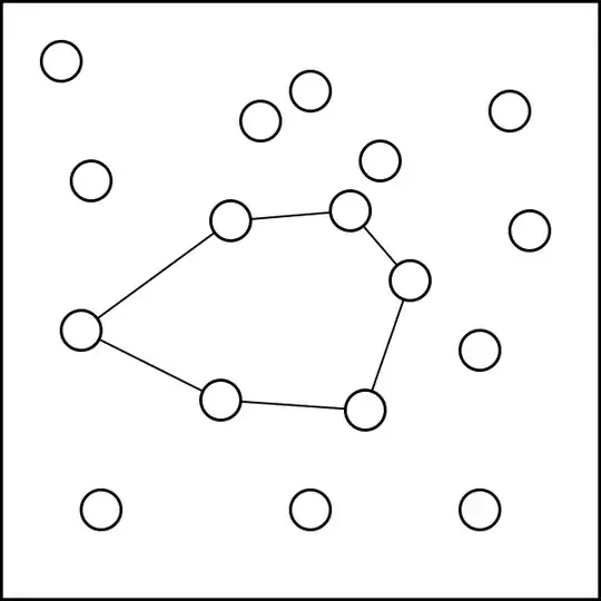

Suppose I choose $n$ points uniformly at random from the unit square $[0,1]\times [0,1]$, obtaining a set of points $S=\{p_1,\ldots, p_n\}\subset [0,1]\times [0,1]$. Then $S$ may contain subsets which span an empty convex polygon. For example, in the illustration below, we have an empty convex polygon with $6$ corners. A polygon is "empty" if it contains no other point of $S$. Some empty convex hulls may have many corners, some fewer. I am curious about the asymptotic behaviour of this phenomenon. To this end, let
$$ f(S)= \max \{|T|:T\subseteq S\text{ and }T\text{ is convex and } S\cap \text{conv}(T)=T\}$$
Question. How does the expectation $\mathbb E[f]$ grow as $n\to\infty$?
Conjecture. $\mathbb E[f]=\Theta(\sqrt{n})$, due to the birthday paradox.
I think this is a Ramsey Theory type question, but I am not equipped to answer it. I would be happy with either a lower bound or an upper bound, or pointers to finding them.

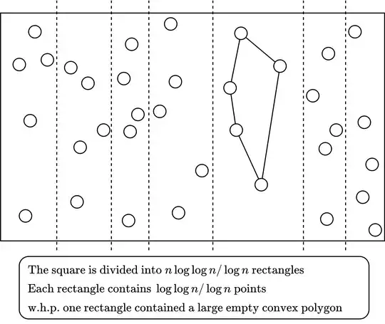

Let me give an exposition of their surprisingly simple argument that you are likely to find such a large empty convex polygon.
First: The probability that $r$ points form a convex polygon is known (exactly! due to Valtr [2]), if the points are drawn from any parallelogram, namely it is $$ \mathbb P[r \text{ points are convex}]=\left(\frac{\binom{2r-2}{r-1}}{r!}\right)^2$$
They now imagine that we get to repeatedly draw $r$ points at random from a parallelogram; if we have an $r$-sided convex polygon, the experiment is a success; otherwise, we repeat the experiment on a clean slate. Then they ask: How many times would we have to repeat this experiment, drawing $r$ points each time, before we saw a polygon with $r$ sides? It turns out that choosing $n$ satisfying $r=\frac{\log(n)}{2\log\log(n)}$ does the trick: then we do $n/r$ independent experiments before we see our first convex $r$-sided polygon, drawing a grand total of $n$ points over all experiments. So we have our bound.
Very good, but this would only work if we had $n/r$ disjoint parallelograms to work with. But we don't, because in our setting we draw all our points from the $[0,1]\times [0,1]$ square, so our $n/r$ "experiments" are not independent. How do we solve this?
The authors use a clever trick here. Namely, suppose that we have drawn $n$ points at random, and assume wlog that no two of them lie on a vertical line. Then we may group the points from left to right in groups of $r$ points, so that the square is cut up into $n/r$ long rectangles, as in the illustration below.
These points lie in non-overlapping rectangles. Moreover, conditioned upon the fact that a given rectangle contains $r$ points, they have been drawn uniformly at random from that rectangle, and so our bound applies anyway!
Q.E.D.
They then prove that this is in fact the largest polygon you are likely to find, but via a more involved argument, which I leave for the reader to explore.
