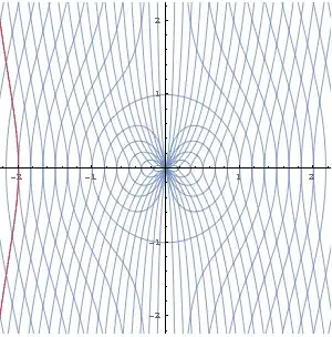

The Family in the Question
The family of curves parametrized by $$ (a+\cos(t),a\tan(t)+\sin(t))\tag1 $$ that are given in the question is
This family does not seem to have an envelope, except perhaps where they self-intersect at $(0,0)$. To compute the envelope, we need to solve $$ \left.\frac{\partial}{\partial a}(a+\cos(t),a\tan(t)+\sin(t))\,\middle\|\,\frac{\partial}{\partial t}(a+\cos(t),a\tan(t)+\sin(t))\right.\tag2 $$ that is, $$ \left.(1,\tan(t))\,\middle\|\,\left(-\sin(t),a\sec^2(t)+\cos(t)\right)\right.\tag3 $$ whose solution is $$ -\cos(t)=a\tag4 $$ which, when plugged back into $(1)$, gives a one point envelope at $(0,0)$ when $-1\le a\le1$.
