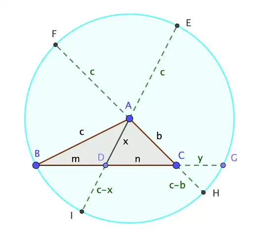

$\triangle ABC$ is our reference triangle. Draw the circle centered at $A$ with radius $c$. Extend segments as shown in the figure. Using the power of a point at points $D$ and $C$, we get two equations:
$$c^2-x^2=m\cdot (n+y) \;\; \text{and} \; \; c^2-b^2=(m+n)\cdot y$$
Solving simultaneously (eliminating $y$) yields Stewart's Theorem. $\;\blacksquare$
What is meant by elementary geometry is rather controversial (power of a point $=$ similarity).

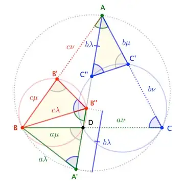

Write $m:=a\mu$ and $n:=a\nu$. The highlighted similar triangles $\triangle A'DB$, $\triangle B''B'B$, $\triangle C''C'A$ in the figure (whose construction is detailed below) have corresponding sides in proportion, say, $\lambda:\mu$; we deduce $\triangle ABC\sim\triangle B''BA'$, so that $|A'B''|=b\lambda=|AC''|$, and we can write $|AA'|=|AC''|+|AB''|$.
Now, we simply apply the Intersecting Chords/Secants theorems thusly
$$ \begin{align} \color{green}{a\mu\cdot a\nu} = \overbrace{\color{green}{|AD|\,|A'D|}}^{\bigcirc ABC} &= |AD|\,(\,|AA'|-|AD|\,) \\[0.5em] &= |AD|\,(\,\color{blue}{|AC''|}+\color{red}{|AB''|}-|AD|\,) \\[0.5em] &=\overbrace{\color{blue}{|AC|\,|AC'|}}^{\bigcirc CC'C''}+\overbrace{\color{red}{|AB|\,|AB'|}}^{\bigcirc BB'B''} - |AD|^2 \\[0.5em] &=\color{blue}{b\cdot b\mu}+\color{red}{c\cdot c\nu} - d^2 \tag{$\star$} \end{align}$$
giving the equivalent of Stewart's Theorem. $\square$
The diagram is created by extending cevian $\overline{AD}$ to meet the circumcircle at $A'$. Then $B'$ and $C'$ divide $\overline{BA}$ and $\overline{AC}$ in the ratio $\mu:\nu$, and circumcircles $\bigcirc DBB'$ and $\bigcirc DCC'$ meet the cevian in points $B''$ and $C''$. A little angle-chasing establishes the similarity of the highlighted triangles.
Admittedly, that's quite a bit of setup —and perhaps there's an easier path to the key relation $|AA'|=|AB''|+|AC''|$— but I rather like how $(\star)$ falls right out.

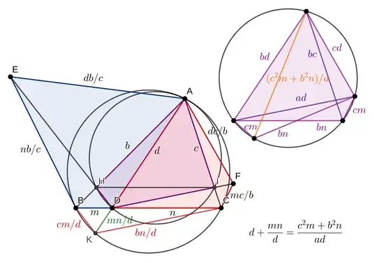

I have found a proof through Ptolemy's theorem and the intersecting chords theorem, but it is rather messy, sketched in the following diagram (beware: I accidentally swapped $m$ and $n$) enter image description here
Let us consider two spiral similarities bringing $ACD$ to $ABE$ and $ADB$ to $AFC$. Since we have supplementary angles at $D$, $ADBE$ and $AFCD$ are similar and cyclic. Their sides and diagonals are proportional to the sides and diagonals of the purple quadrilateral in the top right. The lengths of the diagonals are fixed by Ptolemy's theorem. Let us consider the intersection $K$ between $AD$ and the circumcircle of $ABC$: the quadrilateral $ABKC$ is similar to the quadrilateral with the orange diagonal, so $AK=\frac{c^2 m+b^2 n}{ad}$. On the other hand, by the intersecting chords theorem, $AK=d+\frac{mn}{d}$. This proves Stewart's theorem.
Jack D'Aurizio
