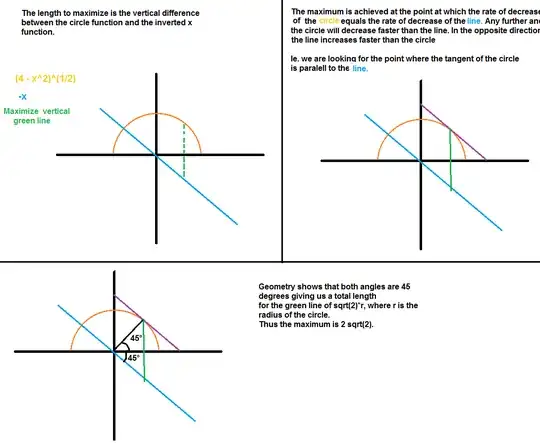

I've sketched a purely geometric proof (tough it does informally use the rate of change). enter image description here
user3257842

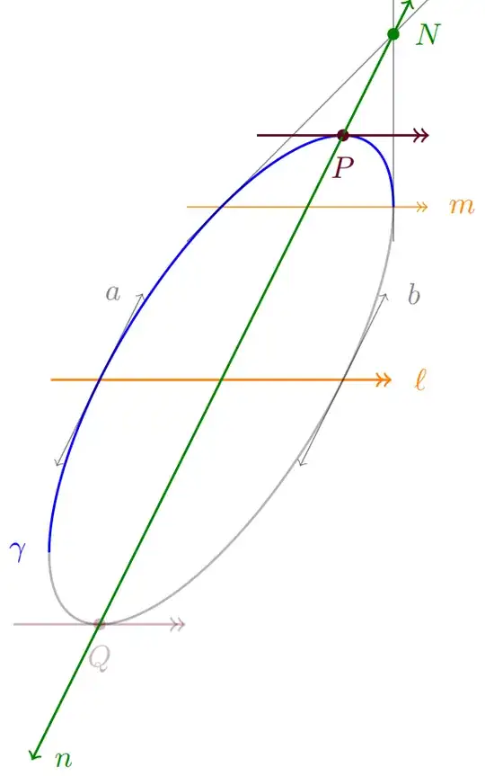

The graph of the function comprises half an ellipse. The $x$-axis is a diameter for this ellipse. Finding the maximum of the function entails finding tangents to the ellipse parallel to the $x$-axis.
So suppose given a conic section $\gamma$ with diameter $\ell$. Construct, with straightedge and parallel rule:
  1. $m$, an arbitrary line parallel to and distinct from $\ell$;
  2. $N$, the polar point of $m$;
  3. $a$ and $b$, the parallel tangent lines to the intersection points of $\ell$ with $\gamma$ ($a$ and $b$ can be constructed by Pascal's theorem);
  4. $n$, the unique line through $N$ parallel to $a$ and $b$; and
  5. $P$ and $Q$, the intersection points of $n$ with $\gamma$.
Then $P$ and $Q$ are the two points on $\gamma$ whose tangents are parallel to $\ell$.
Diagram of the construction of points whose tangents are parallel to a given diameter of a conic.
The point of this exercise in synthetic geometry is to show that finding the maximum of the function reduces to a question of affine geometry, so that we are free to make affine-linear transformations of the coordinates to simplify to, e.g., the case of the circle. I think that's the spirit of what several other of the answers have done.
