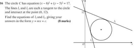

I'm asking about a question about two lines which are tangents to a circle. Most of the question is quite elementary algebra, it's just one stage I can't get my head round. Picture here:
The circle $C$ has equation $(x-6)^2+(y-5)^2=17$. The lines $l_1$ and $l_2$ are each a tangent to the circle and intersect at the point $(0,12)$. Find the equations of $l_1$ and $l_2$ giving your answers in the form $y=mx+c$.

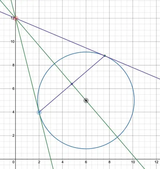

An approach using geometry:
Let $P = (0,12)$ and the two tangent points be $A, B$. Then $OP^2 = (0-6)^2 + (12-5)^2 = 85$, and the radius $AO^2 = 17$, so $PA^2 = PB^2 = 68$ as tangents to the circle are the same length.
Draw a line connecting $A$ and $B$, and call its intersection with $OP$, $M$. By similarity ($\Delta PAO \sim \Delta AOM$) and using power of a point, $(2k)^2 = (\sqrt{17} + k)(\sqrt{17} - k) \implies 4k^2 = 17 -k^2 \implies k^2 = 17/5$, where $k = AM = BM$.
The line $OP$ has gradient $\frac{5-12}{6-0} = -\frac{7}{6}$, so the equation of the line is $y = -\frac{7}{6}x + 12$. Making a right triangle with $OM$ as the hypotenuse, $\text{run}^2 + \text{rise}^2 = 17/5$, or $x^2 + \left(\frac{7}{6}x\right)^2 = 17/5 \implies x = -\frac{6}{5}$, so $M$ has $x$-coordinate $6 - \frac{6}{5} = \frac{24}{5}$ and $y$-coordinate $\frac{32}{5}$.
Also, since $OP \perp AB$ using another circle theorem, $AB$ has gradient $\frac{6}{7}$ and $AM$ has length $2k$. Drawing another right triangle with hypotenuse $AM$, $x^2 + \left(\frac{6}{7}x\right)^2 = 68/5 \implies x = -\frac{14}{5}$, so $A$ has coordinates $\left(\frac{24}{5} - \frac{14}{5}, \frac{32}{5} - \frac{14}{5} \cdot \frac{6}{7} \right) = (2,4)$. Now $BM$ has the same length in the opposite direction, so $B = \left(\frac{24}{5} + \frac{14}{5}, \frac{32}{5} + \frac{14}{5} \cdot \frac{6}{7} \right) = \left(\frac{38}{5}, \frac{44}{5} \right)$.
Now use point-slope form to find the equation of the lines $PA,PB$, and you will get $-\frac{8}{19}x + 12, -4x + 12$.
Desmos graph is here.

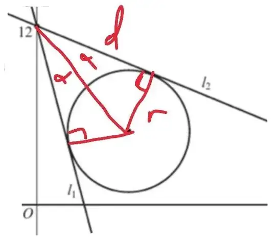

Geometrically, there is a very intuitive solution however, using symmetry
Draw the diagram like this
Edited pic
(Call the distance from the intercept to the centre of the circle, D, I forgot to mark that)
We can immediately see that
  • the two tangents are symmetrical in the sense shown.
  • from the equation, the circle's centre and radius are (6,5) and √17.
  • the distance from the intercept (0,12) to the circle centre (6,5) is D = √(62+(12-5)2) = √85
Now let's find the angle ɑ. We have a right angle triangle so ɑ = sin-1(D/r) = sin-1(√17/√85) = sin-1(1/√5) = 26.565 degrees.
Last, let's find the angle (not gradient!) of the line between the intercept and the center of the circle. The gradient is (5-12)/6 = -7/6 so the angle is tan-1(-7/6) = -49.399 degrees.
By construction, the two triangles are identical sides and angles, so the two gradients are lines that pass through (0,12) at angles -49.399 ± 26.565 degrees, or -75.965 and -22.834 degrees.
Converting the angles of the lines back to gradients, we get that the tangents have gradients: tan(-75.965) and tan(-22.834), or -4 and -0.421 (which as you expected, is -8/19).
We know that both tangents have lines with formulae y = 12 - mx, because they are straight lines passing through (0,12). Note that ive used "-m" for clarity here, we expect two negative numbers, although mathematically its cleaner to use "+mx".
So the tangents have equations:
y = 12 - 4 x
and
y = 12 - 0.421 x
Not a quadratic in sight!
In general, converting questions about tricky tangents to circles, into questions about right angle triangles based on a radius and a tangent to a circle, is a trick that should be in any mathematician's toolbox.
