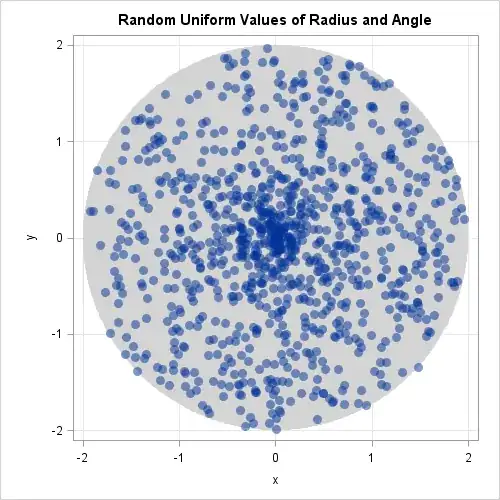

If we want to generate points in a circle $D^2$ randomly but uniformly on a computer, it is a bit tricky. We cannot easily say "create points uniformly on a circle", as most programming languages only provide uniformly generated random points on an interval. But we have the polar coordinate transformation
$$ \Phi \colon (0,R) \times (0,2 \pi) \to D^2 \;,$$
so we can randomly choose points on those two intervals, right? Wrong! What we would get is the following.
This polar coordinate transformation "stretches and squashes" space non uniformly, making the points denser for smaller radii and less dense for larger radii. So we need to somehow transform the randomly generated points before we transform them to the disc in the end.

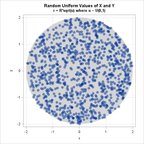

The answer is to randomly generate points uniformly on $(0,1)^2$, and then apply the function
$$\Psi \colon (0,1)^2 \to (0,R) \times (0,2\pi)\;, \; (r,\theta) \mapsto (R\sqrt{r}, 2\pi\theta) \;,$$
and only then apply the polar coordinate transformation $\Phi$, after which we get the desired result.
