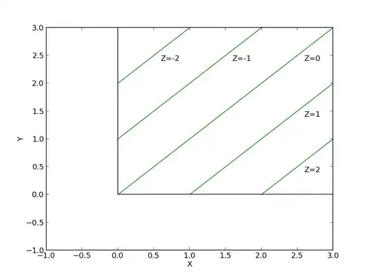

The following hopefully explains the "split integral into two" statement you mentioned.
If you take two exponentials $X$ and $Y$ with support $\mathbb{R}^+_0$ then the variable $Z=X-Y$ has support $\mathbb{R}$.
To arrive at the "convolution" of the two, just find the values of $X$ and $Y$ so that their difference is $Z$. A graph is useful for explaining this:
Basically, the "convolution" needs to integrate along the green lines.
With this you can see why it is good to split it into two parts: the minimum $X$ or $Y$ is not smooth at $Z=0$.
So, if $z\geq0$ we need to consider values of $x \geq z$ and $y \geq 0$, which means we do the integral:
$$p_+(z) = \int_0^\infty p_X(s+z)p_Y(s) ds$$ $$ = \int_0^\infty f(s+z)g(s) ds$$ $$ = \lambda\mu\int_0^\infty e^{-\lambda (s + z) - \mu s }$$ $$ = \lambda\mu e^{-\lambda z}\int_0^\infty e^{-(\lambda + \mu)s}$$ $$ = \frac{\lambda\mu}{\lambda+\mu}e^{-\lambda z}$$
and for $z \leq 0$ we consider the values of $x \geq 0$ and $y \geq -z$, which means we do the integral:
$$p_-(z) = \int_0^\infty p_X(s)p_Y(s-z) ds$$ $$=\frac{\lambda\mu}{\lambda+\mu}e^{\mu z}$$
Combining the two gives:
$$p(z) = \frac{\lambda\mu}{\lambda+\mu} \left\{\begin{array}{ll} e^{-\lambda z} & z \geq 0 \\ e^{\mu z} & z \leq 0 \end{array}\right.$$
