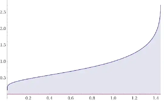

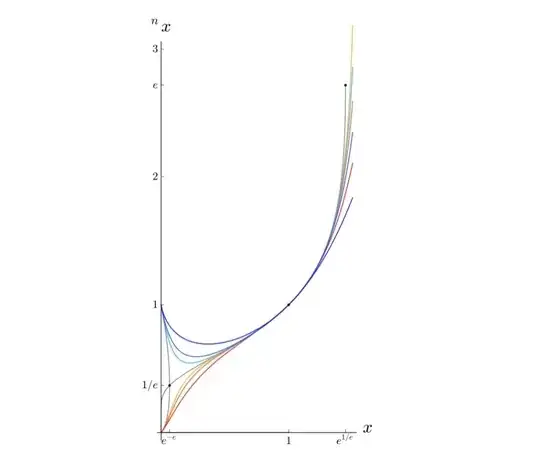

I have been trying to find an interesting constant over the domain of the infinite tetration of x and have just almost figured out the area with a non integral infinite sum representation. Just one constant is in my way. D denotes the domain. This question is different from this one as it has the full domain such that the imaginary part is $0$ and not for a single point. Here is a demo of my expansion. Here is my source for the product logarithm/W-Lambert function series. My inspiration for the series is here.
Finally here is a graph of the constant. My work is as follows. I used a bit of software to help with the evaluation at the end. Here is data about the generalized incomplete gamma function used here.
