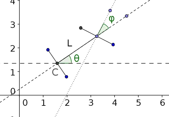

Denote by $C(x,y)$ the center of the back wheel line, $\theta$ the angle of the direction of the car with the horizontal direction, $\phi$ the angle made by the front wheels with the direction of the car and $L$ the length of the car.

  • drive: $D=\displaystyle\cos \theta \frac{\partial}{\partial x}+\sin\theta \frac{\partial}{\partial y}+\frac{\tan \phi}{L}\frac{\partial}{\partial \theta}$;
  • rotation: $R=[S,D]=\displaystyle\frac{1}{L\cos^2 \phi}\frac{\partial }{\partial \theta}$;
  • translation: $T=[R,D]=\displaystyle\frac{\cos \theta}{L\cos^2 \phi}\frac{\partial}{\partial y}-\frac{\sin\theta}{L\cos^2\phi}\frac{\partial}{\partial x}$
