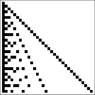

A prime number is a number that is only divisible by itself and one, that is the number of divisors of a prime number is equal to $2$. One way to illustrate this is to plot a matrix such that if the column index (1,2,3,...) divides the row index (1,2,3,...) then a black square is drawn at that column and row index intersection, like this:
divisor plot
As a matrix this has the definition in Mathematica:
MatrixForm[Table[Table[If[Mod[n, k] == 0, 1, 0 ], {k, 1, 12}], {n, 1, 12}]]
which gives the table below:
$$\small \left( \begin{array}{cccccccccccc} 1 & 0 & 0 & 0 & 0 & 0 & 0 & 0 & 0 & 0 & 0 & 0 \\ 1 & 1 & 0 & 0 & 0 & 0 & 0 & 0 & 0 & 0 & 0 & 0 \\ 1 & 0 & 1 & 0 & 0 & 0 & 0 & 0 & 0 & 0 & 0 & 0 \\ 1 & 1 & 0 & 1 & 0 & 0 & 0 & 0 & 0 & 0 & 0 & 0 \\ 1 & 0 & 0 & 0 & 1 & 0 & 0 & 0 & 0 & 0 & 0 & 0 \\ 1 & 1 & 1 & 0 & 0 & 1 & 0 & 0 & 0 & 0 & 0 & 0 \\ 1 & 0 & 0 & 0 & 0 & 0 & 1 & 0 & 0 & 0 & 0 & 0 \\ 1 & 1 & 0 & 1 & 0 & 0 & 0 & 1 & 0 & 0 & 0 & 0 \\ 1 & 0 & 1 & 0 & 0 & 0 & 0 & 0 & 1 & 0 & 0 & 0 \\ 1 & 1 & 0 & 0 & 1 & 0 & 0 & 0 & 0 & 1 & 0 & 0 \\ 1 & 0 & 0 & 0 & 0 & 0 & 0 & 0 & 0 & 0 & 1 & 0 \\ 1 & 1 & 1 & 1 & 0 & 1 & 0 & 0 & 0 & 0 & 0 & 1 \end{array} \right)$$
The number of divisors of n, also called tau, is the row sums of this matrix and starts: 1, 2, 2, 3, 2, 4, 2, 4, 3, 4, 2, 6 ...
So at a row equal to a prime number there are only two black dots and the row sums in the above matrix are equal to 2.
