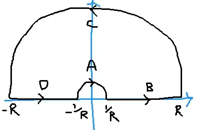

Let $$I = \int_0^\infty \frac{\sin(x)}{x} dx$$
The trick is to work with $\frac{e^{i z}}{z}$ rather than $\frac{\sin(z)}{z}$ when doing a contour integral.
In the case of $\frac{\sin(z)}{z}$ the singularity is removable. With $\frac{e^{i z}}{z}$ the singularity at 0 is essential. Consider the following contour:
We will let $R \to \infty$.
By Cauchy's theorem
$$ \begin{align} 0 =& \int_\gamma \frac{e^{i z}}{z} dz \\ =& \int_{A \oplus B \oplus C \oplus D} \frac{e^{i z}}{z} dz \\ =& \, 2 i \cdot I - i \pi + 0 \\ \end{align} $$
thus
$$I = \tfrac{\pi}{2}.$$
$$ \begin{align} & \int_{B \oplus D} \frac{e^{i z}}{z} dz \\ =& \int_{1/R}^{R} \frac{e^{i z}}{z} dz + \int_{-R}^{-1/R} \frac{e^{i z}}{z} dz \\ =& \int_{1/R}^{R} \frac{e^{i z}}{z} dz + \int_{R}^{1/R} -\frac{e^{-i z}}{-z} dz \\ =& \int_{1/R}^{R} \frac{e^{i z}}{z} dz - \int_{1/R}^{R} \frac{e^{-i z}}{z} dz \\ =& \int_{1/R}^{R} \frac{e^{i z} - e^{-i z}}{z} dz \\ =& \, 2i \cdot I \\ \end{align} $$
For paths $A$ and $C$ note that $\gamma'(t) = i \pi \gamma(t)$.
$$ \begin{align} & \int_{A} \frac{e^{i z}}{z} dz \\ =& - \int_0^1 \frac{e^{i (1/R) e^{i \pi t}}}{\gamma(t)} i \pi \gamma(t) dt \\ =& - i \pi \int_0^1 e^{i (1/R) e^{i \pi t}} dt \\ \to& -i \pi \end{align} $$
For the final part we will use estimation to show that
$$ \begin{align} & \int_{C} \frac{e^{i z}}{z} dz \\ =& \int_0^1 \frac{e^{i R e^{i \pi t}}}{\gamma(t)} i \pi \gamma(t) dt \\ =& \, i \pi \int_0^1 e^{i R e^{i \pi t}} dt \\ \to& \, 0 \end{align} $$
because
$$ \begin{align} & \left| \int_0^1 e^{i R e^{i \pi t}} dt \right| \\ \le& \int_0^1 \left| e^{i R e^{i \pi t}} \right| dt \\ \le& \int_0^1 \frac{\left| e^{i R \cos(\pi t)} \right|}{\left| e^{R \sin(\pi t)} \right|} dt \\ \le& \int_0^1 \frac{1}{\left| e^{R \sin(\pi t)} \right|} dt \\ \le& 2 \int_0^{1/2} \frac{1}{\left| e^{R \sin(\pi t)} \right|} dt \\ \le& 2 \int_0^{1/2} \frac{1}{\left| e^{R \pi t} \right|} dt \\ \to& \, 0 \end{align} $$
