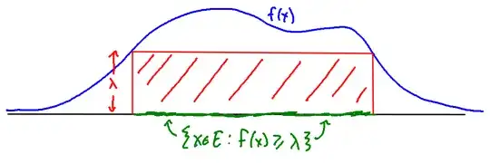

It can be helpful to draw a picture:
Here:
  • the blue curve is $f(x)$,
  • the base of the red box is the set $\{x \in E: f(x) \ge \lambda\}$,
  • the height of the red box is $\lambda$.
Chebyshev's inequality says that the area in the red box is less than the area under the blue curve $f(x)$.
The only issue with this picture is that, depending on $\lambda$ and $f$, you might have multiple boxes under the curve at different locations, instead of just one. But then the same thing applies to the sum of the areas under the boxes.

  • helpful to think of probability here? or not really? i was thinking back to my 1st question on maths se Borel-Cantelli Lemma “Corollary” in Royden and Fitzpatrick – BCLC May 13 '21 at 03:47
  • 9
    I was looking for this answer! Life changing when I first saw it. +1 – dafinguzman May 13 '21 at 05:02
  • The picture is nice. However, in the last paragraph of the answer there is a flaw. The "multiple boxes" may be uncountable many ones. So we can not simply consider "the sum of the areas under the boxes". Example: take $f$ to be the indicator function of the irrationals in $[0,1]$ and $\lambda =1/2$, consider ${x \in [0,1] \mid f(x) \geq 1/2}$. In this case we will have an uncountable set of "boxes". – Ramiro May 15 '21 at 11:59
  • @Ramiro Sure. Or, for a countably infinite example, the indicator function on the fat cantor set. And probably "most" measurable functions are pathological like this in some sense. But my goal here is to provide intuition, not a proof (the proof is pretty much trivial once one understands the concept) – Nick Alger May 15 '21 at 12:39
    @Ramiro I'd also like to add that the idea of thinking about measures in terms of sums of boxes is actually a good intuition, as this mirrors the process of how the Lebesgue outer measure is constructed. – Nick Alger May 15 '21 at 13:01
  • When there are countably many boxes, it is OK. But the point is that in the general case, there may be uncountably many boxes, so "the sum of the areas under the boxes" doesn't work. – Ramiro May 15 '21 at 14:23
  • Thinking in terms of sums of boxes may be appropriate for outer measures induced by pre-measures, but it may not apply directly to measures. – Ramiro May 15 '21 at 14:28
