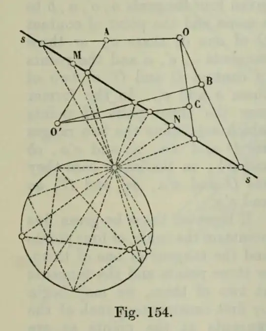

Projective geometry textbooks from the 19th and early 20th centuries are the best place to find recipes for constructions like this.
The basic idea is to construct an involution on the line, the fixed points of which are the points of intersection of the line and conic.
One such construction is given in Cremona, Projective Geometry, Art. 212 (pg 211). You'll notice it's more work than finding more points on the conic, but it'll expand your toolkit of constructions.
(Here's a cleaner copy)
The excerpted diagram below shows the five points $O,O',A,B,C$ that define the conic, along with the line $s$. The points $M,N$ are the points of intersection of the line and conic, and are constructed via a reverse and forward stereographic projection to and from a circle. How cool is that?
