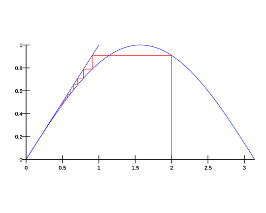

It's almost as if the maths Gods knew you were going to ask this question, because Wikipedia even has a nice diagram of what's going on in your exact example!
The diagram shows what happens with $x_0 = 2$. You get a staircase diagram converging towards the only root of the equation $x = \sin(x),\ $ namely $x = 0.$

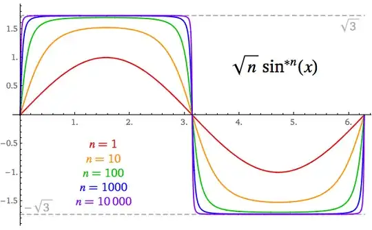

Graphical Verification
Limit $(7)$ holds for any $a_0\ne0$. Since $\sin(x)$ is an odd function, changing the sign of $a_0$, changes the sign of all $a_n$. Thus, we have that $$\newcommand{\sgn}{\operatorname{sgn}} \lim_{n\to\infty}\sqrt{n}\,a_n=\sqrt3\sgn(a_0)\tag{14} $$ Therefore, if we define $\sin^{\ast n}(x)$ to be the $n$-fold composition of $\sin(x)$, we get $$ \bbox[5px,border:2px solid #C0A000]{\lim_{n\to\infty}\sqrt{n}\sin^{\ast n}(x)=\sqrt3\sgn(\sin(x))}\tag{15} $$ Here is graphical verification of $(15)$:
Asymptotically, $(15)$ says that $$ \bbox[5px,border:2px solid #C0A000]{\sin^{\ast n}(x)\sim\sqrt{\frac3n}\sgn(\sin(x))}\tag{16} $$ which would be a more precise way of saying what you were trying to say.
