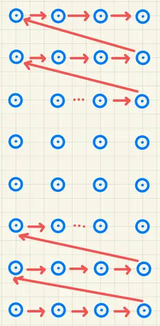

Example 1. Let $A=\{0<1<2<\cdots<p-1\}$ and $B=\{0<p<2p<\cdots<(q-1)p\}$. The equivalence classes of $\sim_{A,B}$ are singletons (this is uniqueness of euclidean division).

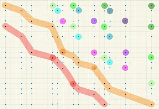

Antidiagonal Propagation. Suppose $A=\{a_1<a_2<\cdots<a_n\}$, $B=\{b_1<b_2<\cdots<b_n\}$ with $n=mT+r$ with $m+1\geq 3$, $T\geq 1$, $\newcommand{\T}{[\![1,T]\!]}r\in\T$. Suppose $$\newcommand{\n}{[\![1,n]\!]} \forall i,j\in\n, \quad \begin{cases} i+j=n+1:& a_i+b_j=C\\ i+j=n+1-T:& a_i+b_j=D \end{cases}$$ Then $$\newcommand{\n}{[\![1,n]\!]} \forall i,j,k,l\in\n, \quad \left\{ \begin{array}{l} i\equiv k\mod T,\\ j\equiv l\,\mod T,\\ \text{and }i+j=k+l \end{array} \right\} \implies (i,j)\sim_{A,B}(k,l)$$
In other words if $(i,j)$ and $(k,l)$ lie on the same antidiagonal and are a multiple of $T$ positions apart then they are $\sim_{A,B}$-equivalent.
Proof. The condition implies that, setting $\Delta=C-D$, $$ \left\{ \begin{array}{lll} a_{1+kT}=a_1+k\Delta, & b_{1+kT}=b_1+k\Delta & ~\text{for }k=0,1,\dots,m-1,m\\ a_{2+kT}=a_2+k\Delta, & b_{2+kT}=b_2+k\Delta & ~\text{for }k=0,1,\dots,m-1,m\\ \qquad\vdots&\qquad\vdots&\qquad\vdots\\ a_{r+kT}=a_r+k\Delta, & b_{r+kT}=b_r+k\Delta & ~\text{for }k=0,1,\dots,m-1,m\\[2mm]\hline a_{r+1+kT}=a_{r+1}+k\Delta, & b_{r+1+kT}=b_{r+1}+k\Delta & ~\text{for }k=0,1,\dots,m-1\\ \qquad\vdots&\qquad\vdots&\qquad\vdots\\ a_{T+kT}=a_T+k\Delta, & b_{T+kT}=b_T+k\Delta & ~\text{for }k=0,1,\dots,m-1 \end{array} \right. $$ and thus if $i\equiv k\mod T$, say $i=IT+\tau$, $k=KT+\tau$, $j\equiv l\mod T$, say $j=JT+\sigma$, $l=LT+\sigma$, and $i+j=k+l$ i.e. $I+J=K+L$, then $$ a_i+b_j = a_\tau+b_\sigma+(I+J)\Delta = a_\tau+b_\sigma+(K+L)\Delta = a_k+b_l $$

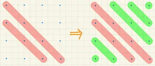

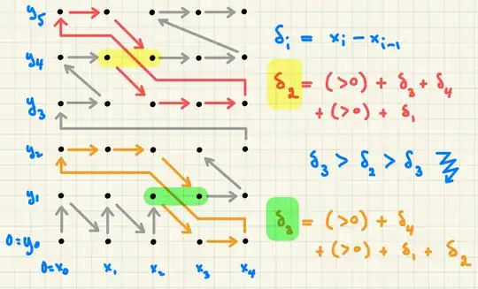

Here is an illustration. You have two large equivalence classes:
You focus on the lines and columns that contain these equivalence classes and chuck the others out for now. Then there are some automatic equivalences depicted below. Equivalence classes are always subsets of antidiagonals, i.e. sets of the form $\{(i,j)\mid i+j=\mathrm{cst}\}$ and are color coded there. For extra clarity I've also added some markings to some of the equivalence classes. Funnily these look like designs straight out of the 1960ies and 1970ies.

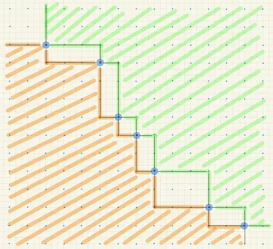

There is an obvious necessary condition for a total order on $R_{p,q}/\sim$, where $\sim$ is realizable, to be realizable. Suppose $c,d$ are equivalence classes. We say that $d$ is visibly greater than $c$ if there exists some $i$ with $V_i$ intersecting both $c$ and $d$ and such that if $(i,a)\in c$ and $(i,b)\in d$ then $a<b$, or if there is some $j$ with $H_j$ intersecting both $c$ and $d$ and if $(a,j)\in c$ and $(b,j)\in d$ then $a<b$. We allow ourselves to say that $c$ is visibly greater than $d$ if there is a chain $c=c_0,c_1,\dots,c_n=d$ with $c_i$ visibly greater than $c_{i-1}$ (i.e. we consider the transitive closure of the previously defined relation).
Visibility. If $c$ is visibly greater than $d$ then $c<d$.

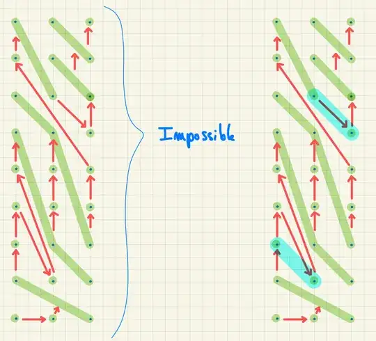

Counter Example for realizability of $<$

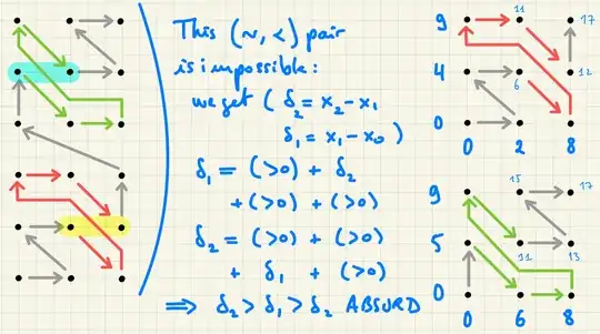

There's more to this, yet. Consider the following discrete equivalence relation (i.e. equivalence classes are singletons) and total order $<$. This total order satisfies all previously proposed conditions but can't arise as a $\sim_{A,B}$ and $<_{A,B}$.
Here's a simpler counter example showing that the individual $3\times 3$ orders are realized.

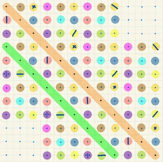

Beginnings of a positive solution for $p=2$

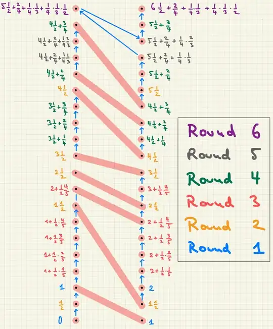

I believe the answer is positive to both questions at least when $p=2$. WLOG we can take $a_1=0$, $a_2=1$ and $b_0=0$. There seems to exist an explicit algorithm to find a rational solution to the problem. I've illustrated it below. The necessary and sufficient condition on $\sim$ in the case $p=2$ seems to be that the lines associated to $2$-element equivalence classes don't intersect. The algorithm is simple but I haven't conceptualized it really:
  • You start with $b_1=0$, the sum in the the lower left corner $(1,1)$ is thus $0$ since $a_1=0$
  • You put $1$ in the lower right corner $(2,1)$, the sum is $1$ since $a_2=1$
  • If the lower right corner is part of a $2$ element equivalence class you put are forced to attribute $1$ to the other member $(1,r)$.
    • if $r>2$ you set $b_r=1$. This is the case in the example below so you set $b_3=1$. Then you are forced to put a $2$ in position $(2,r)$ since $a_2=1$. You keep on going until you don't fall into a 2 element equivalence class.
  • Then you have to insert values for $b_2,\dots,b_{r-1}$. You pick them uniformly apart between $b_1=0$ and $b_r=1$, that is $b_k=\frac{k-1}r$.
  • Then you are forced to inscribe $b_k+1$ on the right hand side. If the right hand side is part of a $2$ element equivalence class you are forced to set the same value for some new $b_s$ etc ...
I hope the picture below (and the color coded rounds) are more explicit than the half-baked algorithm above.
