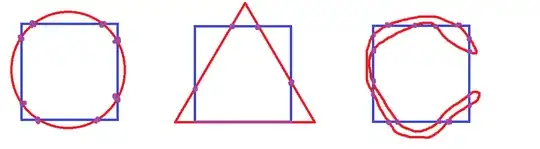

To phrase my question more clearly: Imagine you have a game with two players, Minnie and Maxime. Minnie starts by defining some closed curve. Then Maxime translates, rotates, and scales a square with the goal to maximize the number of intersections between the edges of the square and the curve. Minnie tries to think of a curve to minimize the number of intersections. Is it possible for Minnie to get a curve for which Maxime cannot transform the square to get at least 8 intersections?
For example Maxime will be able to get 8 intersections with a circle, an infinite amount with a triangle (overlapping straight edges) and 16 with some kind of croissant shaped closed curve.
A circle can intersect the square up to 9 times. A triangle an infinite amount when it has an overlapping edge. The third closed curve can intersect the square 16 times.

    What about a very eccentric ellipse? – themaker Apr 08 '21 at 13:41
    @themaker I was thinking that too but you can put a small square in the middle such that the corners poke out but not the side – Giorgio Genovesi Apr 08 '21 at 13:46

    @aldodecristo You're right. Sneaky squares! – themaker Apr 08 '21 at 15:48

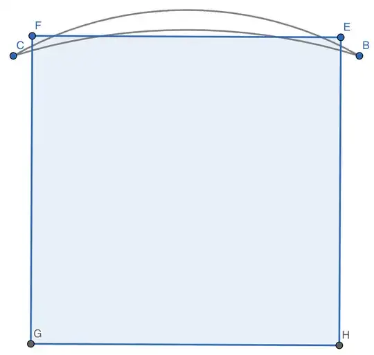

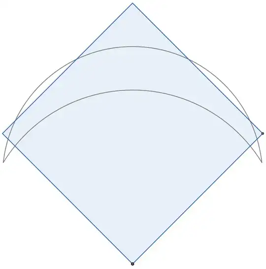

This isn't an answer, but I need to post a picture in order to demonstrate that the crescent idea doesn't work. See the following:
This handles the case where the upper arc subtends more than $\pi/2$ radians. And in the "sufficiently flat" case, we have:
which I think is quite interesting since one side has zero intersections but the opposite side makes up for this by having four. I think this is a key configuration that demonstrates that any non-convex shape admits a line that intersects the boundary at four distinct points.
