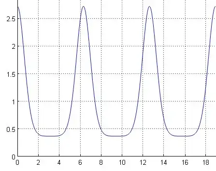

Let
$$f(x):=e^{-\cos x} \cos(\sin x)$$
It is periodic function with the following graphical representation:
As it is symmetrical with respect to vertical line $x=\pi$, it is sufficient to be able to compute
$$I_1:=\int_0^{\pi/2} f(x)dx \ \ \text{and} \ \ I_2:=\int_{\pi/2}^{\pi} f(x)dx$$
The result will be $2(I_1+I_2)$.
