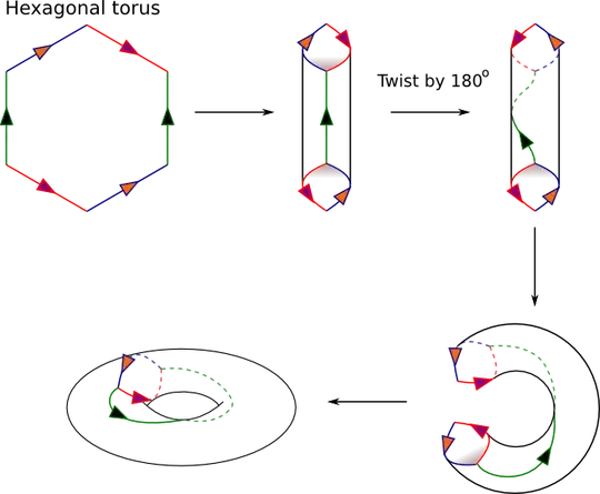

The quotient of the complex plane C by the lattice containing all Eisenstein integers is a complex torus of real dimension 2. This is one of two tori with maximal symmetry among all such complex tori.[citation needed] This torus can be obtained by identifying each of the three pairs of opposite edges of a regular hexagon. (The other maximally symmetric torus is the quotient of the complex plane by the additive lattice of Gaussian integers, and can be obtained by identifying each of the two pairs of opposite sides of a square fundamental domain, such as [0,1] × [0,1].)
This answer explains and shows how identifying opposite sides of a hexagon produces a torus, as do answers to What surface do we get by joining the opposite edges of a hexagon?
Question: Bringing opposite sides of a quadrilateral and a hexagon both produce a torus. Does any polygon side number $2n$ with $n \ge 2$ form a torus when all pairs of opposite sides are joined?

The answer is "no" for the very next case $n=4$. In fact the answer is "no" for all cases $n \ge 4$.
I will assume that your intention is to glue opposite sides by a translation isometry of the plane; or to put it another way, to glue them using matching arrows that point in the same direction on the plane, but in opposite directions around the periphery of the polygon. It follows from this assumption that the quotient surface is orientable.
In that case, let me describe what happens in two cases, depending on whether $n$ is even or odd. The outline is: count the vertex cycles; use that to compute the Euler characteristic; and then apply the classification of surfaces.
Here's the outcome:
  • If $n=2g$ is even, then the $2n$ vertices form $1$ vertex cycle (generalizing the case of the square). The quotient therefore has $1$ vertex, $n$ edges, and $1$ face, thus has Euler characteristic $1-n+1=2-2g$. From the classification of surfaces, it follows that the quotient surface is homeomorphic to the orientable surface of genus $g$.
  • If $n=2g+1$ is odd, then the $2n$ vertices form two vertex cycles (generalizing the case of the hexagon). The quotient surface therefore has $2$ vertices, $n$ edges, and $1$ face, thus has Euler characteristic $2-n+1 = 2-2g$, and again is homeomorphic to the surface of genus $g$.
So to answer your question: No, not in general. The only cases where opposite side gluing gives the torus are the two cases you know, the square and the hexagon.
Generalizing from $n=2,3$ to all $n \ge 2$ is fraught with peril!
Lee Mosher
  • 135,265
  • Thanks! Yes my plan was to apply the arrows and gluing as shown in the hexagon drawing, but seeing this comment one can point all arrows "counterclockwise" and match them up that way. I assume that would have a different result. Do you think that case needs a new question? – uhoh Apr 04 '21 at 14:26
    That's quite different, and leads to a non-orientable surface. I wouldn't say it needs a new question, because there is another option: read up on the proof of the classification of surfaces. That would answer all of your questions. – Lee Mosher Apr 04 '21 at 20:33
