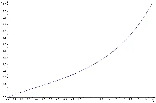

Here is a quick picture of $\ x\mapsto \int_0^x t^t\;dt$

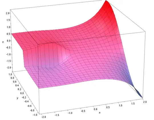

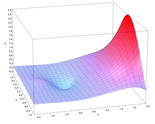

I added the plot of the real and imaginary part of the integral in the complex plane $\ z\mapsto \int_0^z t^t\;dt\ $ with $z=x+iy$ (note the 'branch jump' on the negative axis $(-\infty,0)$).

The values $I(0)=0,\ I(1)\approx 0.7834305107,\ I(2)\approx 2.833876745$ (I am computing the integral...) – Raymond Manzoni May 30 '13 at 20:28
These may be compared to the values provided in the famous "Sophomore's Dream". – Raymond Manzoni May 30 '13 at 20:31

@AnonymousPi: I used MuPad (recent versions of MatLab incorporates this CAS too) and asked directly to plot the numerical integral of $x^x$. You may rewrite $x^x=e^{x\ln(x)}$ to get the expansion proposed by Mhenni and then integrate every term $\int (x\ln(x))^n;dx=$ as done by Alpha (replace $n$ by small integers) but this is rather laborious and not really a Taylor series because of the $\log$ terms... The other thread should really help you more! – Raymond Manzoni Jun 03 '13 at 21:01

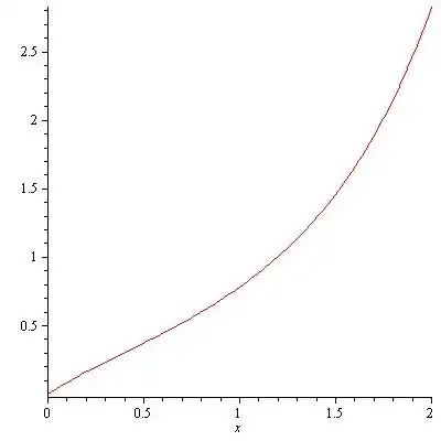

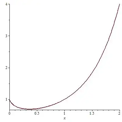

Here is the graph of the function with Maple
Plot( $x^x$, $x=0..2$ );

I'm not sure if the OP wanted the graph of $x^x$, rather of its (presumably "inexistent") integral. – leonbloy May 30 '13 at 20:25
@leonbloy: Ty to read his post again. Thanks for the comment. – Mhenni Benghorbal May 30 '13 at 20:26
@MhenniBenghorbal downvote was me, because I think that Raymond's interpretation of the question was correct, so I think you're answering it incorrectly. – Ben Millwood May 30 '13 at 20:28
1@MhenniBenghorbal: on second thoughts I've revoked the downvote on the grounds that there's enough confusion that it's probably a bad question rather than a bad answer, but it would be worth clarifying (I think that the questioner wants a plot of the integral of the function, rather than the function itself) – Ben Millwood May 30 '13 at 20:29
@BenMillwood: I already put the command plot$( x^x, x=0..2 )$, but you are right. I added that it is the graph of the function. – Mhenni Benghorbal May 30 '13 at 20:42
