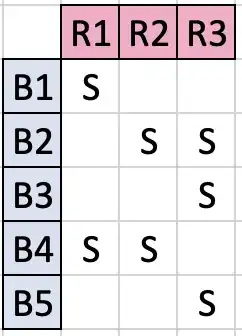

Represent the connected pairs of nails in a $5\times3$ grid, where an $S$ in row $i$ and column $j$ represents a string between the $i$-th blue nail and the $j$-th red nail.
For example, here’s collection that you would want to count, because every nail has at least one string connected to it.
So if I understood your question correctly, you want to count the number of ways to place $S$’s in the grid so that no row or column is $S$-less. Equivalently, you want to count the number of $5\times3$ matrices containing $0$s and $1$s with no row or column that is all zeroes.
That question has been answered in general here, and as you and others recognize, it relies on the inclusion-exclusion principle.
Number of $(0,1)$ $m\times n$ matrices with no empty rows or columns
