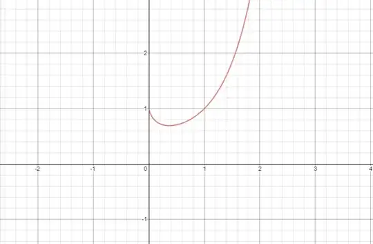

I'd like to understand why $0.3^{0.3}$ is greater than $0.4^{0.4}$. And why the values go on increasing as we go $<0.3$.
So we get $\lim_{x\to 0} x^{x} = 1$.

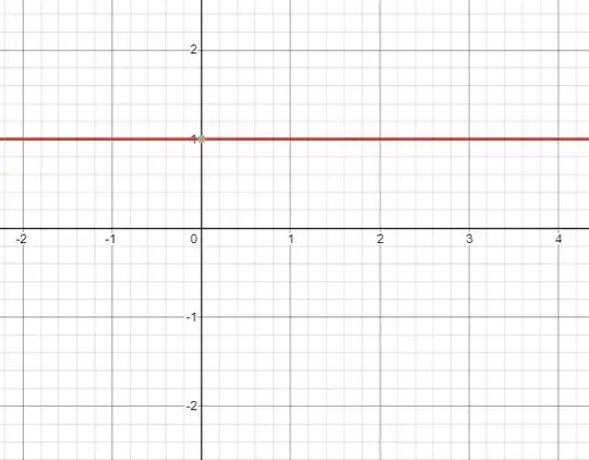

Another amazing graph:
This thing has really intrigued me, and I wonder if there are more ways to prove that $0^0$ is undefined. Sharing more methods for the same would be highly appreciated!
  • The minimum is at $1/e$, as a simple differentiation shows. – user10354138 Feb 28 '21 at 12:33

  • Did you check the graph of $0^x$ (for $x>0$?) – player3236 Feb 28 '21 at 12:55
    Also in set-theory if you identify $0$ with the empty set and $A^B$ with the set of functions $B\to A$ then $0^0={0}=1$. – drhab Feb 28 '21 at 12:57
  • For me $0^x$ is the positive $x$-axis. Anyway more discussion here: https://math.stackexchange.com/questions/11150/ – player3236 Feb 28 '21 at 13:06
As mentioned in the comments you can set the derivative equal to zero to obtain the extreme point. Let $f(x)=x^x, >0$
$\ln(f(x))=x\cdot \ln(x)$
Differentiating. On the left side we use the chain rule.
$\frac1{f(x)}\cdot f'(x)=\ln(x)+1$
$f'(x)=f(x)\cdot (\ln(x)+1)$
$f'(x)=x^x\cdot (\ln(x)+1)$
Setting the derivative equal to zero.
$=x^x\cdot (\ln(x)+1)=0\Rightarrow \ln(x)+1=0$
$\ln(x)=-1\Rightarrow x_E=\frac1e$. And you see that $0.3<\frac1e<0.4$
It remains to show that this extreme point is a (relative) minimum. So we need the second derivative. Using the product rule and we get
$f''(x)=x^x\cdot \left(\frac1x+(\ln(x)+1)^2\right)$
$f''\left(\frac1e\right)>0 \Rightarrow x_E=\frac1e$ is a (relative) minimum.
