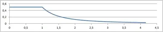

Assming independence...
Consider the following system
$$\begin{cases} g=\frac{\xi}{\nu} \\ u=\xi \end{cases}$$
The Jacobian is $|J|=\frac{\xi}{g^2}$
thus your density is
$$f_G(g)=\frac{1}{2}\cdot\mathbb{1}_{[0;1)}(g)+\frac{1}{2g^2}\cdot\mathbb{1}_{[1;+\infty)}(g)$$

How did you receive the last statement? –
after calculating the jacobian that is $|J|=\frac{u}{g^2}$ you conclude that the joint density is
$$f(u,g)=\frac{u}{g^2}$$
but in the system you see that
$$0<\nu=\frac{u}{g}<1$$
Now, when $0<g<1$ this means that $0<u<g$ thus in this interval to get $f(g)$ you have to integrate the joint density in
$$f(g)=\int_0^g \frac{u}{g^2}du=\frac{1}{2}$$
When $g>1$ there are no problem for $\frac{u}{g}$ to be less than one thus you integrate
$$f(g)=\int_0^1 \frac{u}{g^2}du=\frac{1}{2g^2}$$
... put all together and get the result
this is the drawing of your density
- 33,201
