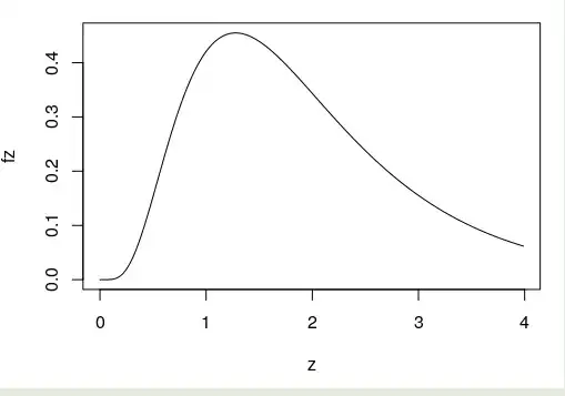

The original question involves $a_m = 2^m$ so we expect a density of the form \begin{equation*} f_\infty(z) = D_0e^{-z} + D_1e^{-2z} + D_2e^{-4z} + D_3e^{-8z} + \dots \end{equation*} The recursion for the leading coefficient yields $D_0 = 1/ \prod_{k=1}^\infty (1 - 2^{-k}) \approx 3.462746619$.
Limiting density
ADDED
The first few coefficients, computed using the recurrence above, are
\begin{align*} m &\qquad\qquad D_m \\ 0 &\qquad +3.46274662e+00 \\ 1 &\qquad -6.92549324e+00 \\ 2 &\qquad +4.61699549e+00 \\ 3 &\qquad -1.31914157e+00 \\ 4 &\qquad +1.75885543e-01 \\ 5 &\qquad -1.13474544e-02 \\ 6 &\qquad +3.60236646e-04 \\ 7 &\qquad -5.67301805e-06 \\ 8 &\qquad +4.44942599e-08 \\ 9 &\qquad -1.74147636e-10 \end{align*}
