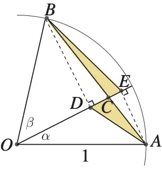

$\def\a{\alpha} \def\b{\beta} \def\t{\theta} \def\ar{\text{area}}$
Here's an unusual way to derive the addition formula for $\sin(\a+\b)$, based on areas of triangles. First, recall that the area of a triangle with two sides $a$ and $b$ and included angle $\t$ is $A=\frac12ab\sin\t$. The steps are outlined.
Consider the diagram below:
Addition law for sin
The points $D$ and $E$ are obtained by dropping perpendiculars from $B$ and $A$, respectively, onto $\overline{OC}$.
$\bullet$ Show that $\triangle ACE \sim \triangle BCD$.
$\bullet$ Show that $(AE)(CD) = (BD)(CE)$ and conclude that $\ar\triangle ACD = \ar\triangle BCE$.
$\bullet$ Explain why \begin{align*} \sin(\a+\b) &= 2\,\ar\triangle OAB = 2\big(\ar\triangle OAC+\ar\triangle OCB\big) \\ &= 2\big(\ar\triangle OAD + \ar\triangle OEB\big). \end{align*}
$\bullet$ Find $OD$ (in terms of $\b$) and $OE$ (in terms of $\a$), and deduce the formula for $\sin(\a+\b)$.
