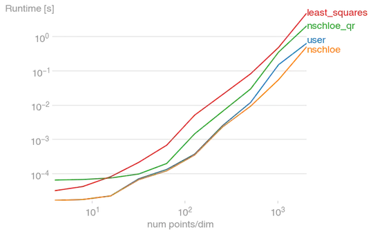

Compared the @user's answer, this one is faster, particularly for large $N$. (Shown here for $n=3$).
Code to reproduce the plot:

def nschloe(Abe):
A, b, e = Abe
V = (A.T - b).T
out = 1 / np.sum(np.linalg.solve(V.T @ V, e))
return out
def nschloe_qr(Abe):
A, b, e = Abe
V = (A.T - b).T
_, r = np.linalg.qr(V)
w = solve_triangular(r.T, e, lower=True, check_finite=False)
w = solve_triangular(r, w, check_finite=False)
out = 1.0 / np.sum(w)
return out
def least_squares(Abe):
A, b, _ = Abe
b -= A[:, 0]
A = (A[:, 1:].T - A[:, 0]).T
_, out, _, _ = np.linalg.lstsq(A, b, rcond=None)
return out[0]
perfplot.show(
# "out.png",
setup=setup,
kernels=[user, nschloe, nschloe_qr, least_squares],
n_range=[2 ** k for k in range(2, 12)],
xlabel="num points/dim"

I've added a more symmetric least-squares approach which gives an arguably nicer result. – Nico Schlömer Feb 14 '21 at 14:25
@NicoSchlömern Your result looks nice but it does not mean that it is computationally more efficient. I am afraid that the opposite is the case. – user Feb 16 '21 at 10:51
How so? Your $U$ is what I call $A^TA$, so the computational difference is the construction of $V$ in favor of the expression I got. – Nico Schlömer Feb 16 '21 at 11:37
@NicoSchlömer No, your matrix is not mine . Mine has dimensions $(n-1)×(n-1) $ and yours - $n×n $, if I don't miss something – user Feb 16 '21 at 11:44
I just tried to compare but I'm struggling to get the correct result from your expression. Here's the gist: https://gist.github.com/nschloe/a901d95bff068e93943d41ba6e4b3a3f – Nico Schlömer Feb 16 '21 at 12:02
@NicoSchlömer I have checked both expressions in Mathematica. They give the same result (with mine being a bit faster). – user Feb 16 '21 at 12:07
I got it now, but I found my answer is still faster. That's because the benefit of solving a -1 smaller system is outweighted by the vector subtractions ($V - v_0$). Added plot plus code to my answer. – Nico Schlömer Feb 16 '21 at 14:09
