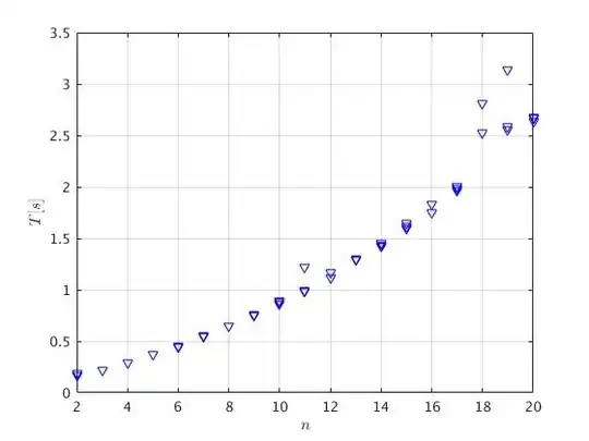

  1. I evaluated the approach for $n=2,\ldots,20$, with $k=1000$. For each $n$ I ran the algorithm 3 times on a uniformly generated set $C$, to which I also apply a random rotation, and time each run. The number of iterations is fixed to $N=5$. In case you are curious, this is the set of MATLAB commands executed to generate the point cloud:

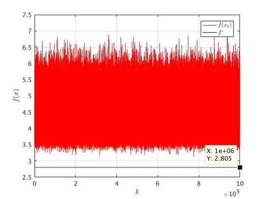

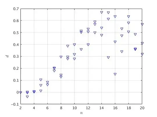

  1. To evaluate how good the solution is, for each run I generate 1000000 points, $\{x_k\}$, normally distributed on the unit sphere in $\mathbb{R}^n$, and evaluate $f$ at each point. Then, I compute $d = \min_k\{f(x_k)\} - f^*$ and plot it. Positive means that the solution is good, negative means the solution is bad. Of course, if positive, this does not mean the solution is the best. Furthermore, the higher the dimension, the lower the quality of this evaluation. Ideally, we want to compare it with another algorithm, which I don't have.
Results:
The first plot shows the execution times vs. $n$. The second plot shows the difference $d$ vs $n$. The final plot is just an arbitrary run for $n=20$, which shows $f(x_k)$ and $f^*$.
Timing
Solution quality
