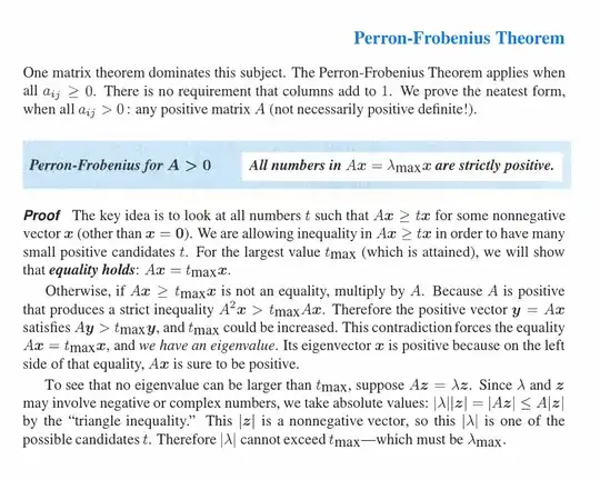

A proof of Perron-Frobenius theorem is given in "Introduction to Linear Algebra" by Gilbert Strang as:
strang
This is asked before, check Perron-Frobenius theorem proof, but the explanation given by @Kavi Rama Murthy only addresses part of the proof which is:
If $y>z$ then $y_j>z_j$ for all $j$, therefore $\sum_{j=1}^{n} a_{ij} (y_j-z_j)>0\implies A(y-z)>0$ since all elements of $A$ is positive.
ie., if $Ax\geq t_{\max}x$ is not an equality then $Ax>t_{\max}x\implies A^2x>t_{\max}Ax$
ie., $Ay>t_{\max}y$ for some positive vector $y$.
Similarly we can also say that for positive matrices, $A(y-z)>0\implies \sum_{j=1}^{n} a_{ij} (y_j-z_j)>0\implies y=z$
I think this much is clear. How can this tell me $t_{\max}$ can be increased ?
Thanks @user8675309, due to the reasoning above when $Ax\geq t_{\max}x$ is not an equality we get the strict inequality $Ay>t_{\max}y$ for a positive matrix $A$. ie., we can increase $t_{\max}$ by a small $\delta t$ till atleast one of the corresponding elements of $Ax$ and $t_{\max}x$ are equal. This leads to the conclusion that $Ax=t_{\max}x$.
But where does the assumption $x\neq 0$ being a non-negative vector affect in this proof ?
And how can one make sense of the rest of the proof ?
