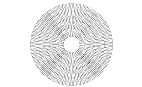

In the weakest case, the number of sides is unbounded, as exhibited by the following example:
(The tiling is constructed by decomposing "wedges" of central angle $2\pi/N$ into congruent isosceles triangles, and then combining the central triangles to yield an $N$-gon in the center.)
Requiring at least $k$ of each tile still yields arbitrarily high numbers of sides, by taking the above construction for $N=M\cdot k$ and subdividing the $N$-gon into $k$ "wedges" which are $(M+2)$-gonal.

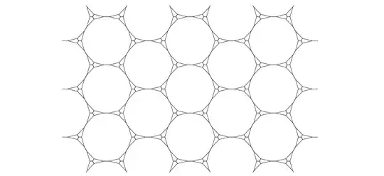

On the other end of the spectrum, I have found a $2$-isohedral tiling using regular $18$-gons, shown below:
After consulting this paper, it seems that the tiling pictured above is of type $4_2 18_{12}-1\text{a}\ \text{MN}\ \text{p}6\text{m}$ in their classification scheme (shown at the bottom of page 109); there are no $2$-isohedral tilings which allow for any higher number of contacts between different shapes, although type $3_1 18_{12}-1\text{a}\ \text{MN}\ \text{p}6\text{m}$ also works (and can be obtained from the above construction by cutting each kite-shaped tile in two). Thus, it is maximal among $2$-isohedral tilings.
