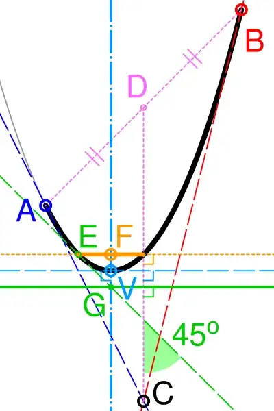

If $(x_1,y_1)$ is the parabola's vertex, the third equation may be obtained from this diagram:
The curve's tangent at the vertex is perpendicular to the line passing between the midpoint of the curve endpoints and the third control point, i.e. $$\begin{bmatrix}\frac{x_0+x_2}2-x\\\frac{y_0+y_2}2-y\end{bmatrix}\cdot\begin{bmatrix}x'(t)\\y'(t)\end{bmatrix}=0$$
A resultant computation followed by factoring out bogus solutions then shows that $t$ solves the cubic $$\begin{align} (\Delta x_2^2+\Delta y_2^2)&t^3\\ -3(\Delta x_1\Delta x_2+\Delta y_1\Delta y_2)&t^2\\ +(\Delta x_1(2\Delta x_1+\Delta x_2)+\Delta y_1(2\Delta y_1+\Delta y_2))&t\\ -(\Delta x_1^2+\Delta y_1^2)&=0 \end{align}$$

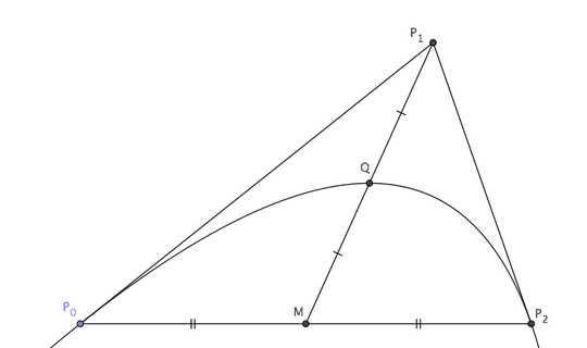

Let $P_0$ and $P_2$ be startpoint and endpoint of a quadratic Bézier curve. If by "maximum point" you mean that point $Q$ on the curve which is at the maximum distance from line $AB$ (this is not the same as the vertex of the parabola, in general), then finding the control point $P_1$ is easy, because $Q$ is the midpoint between $P_1$ and the midpoint $M$ of $AB$.
Note that the tangent to the curve at $Q$ is parallel to $AB$ and $Q$ is obtained by substituting $t=1/2$ in the equation of the curve: $$ B(t)=(1-t)^{{2}}P_{0}+2t(1-t)P_{1}+t^{{2}}P_{2}. $$
