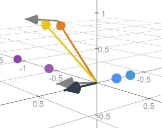

So we have something more like $\vec A(a,b,c)=\left\langle A_x,A_y,A_z\right\rangle=\left\langle A_x(a,b,c),A_y(a,b,c),A_z(a,b,c)\right\rangle$. $\dfrac{\partial A_x}{\partial y}$ then measures how much the $x$-component of the output changes with a small change to $b$, the $y$-component of the input. The $A_z$ displayed in the picture in the OP only shows the value of $A_z$ for a particular input $(a,b,c)$. And to approximate the derivative $\dfrac{\partial A_x}{\partial y}$, we need to look at both $(a,b,c)$ and $(a,b+h,c)$ for a small value of $h$.
We can look at this situation pictorially in this example:
points and vectors as described
There are two vectors from a vector field $\vec A(x,y,z)$ floating off in space (not shown) positioned with tails at $(a,b,c)=(?,-1.1,?)$ and $(a,b+h,c)=(?,-1.1+0.5,?)=(?,-0.6,?)$. You can see the $y$-coordinates of the tails/inputs marked in purple on the $y$-axis.
Those vectors have been translated to have tails at the origin as orange and yellow vectors (with yellow corresponding to $\vec A(a,b+0.5,c)$). The $x$-coordinates of these outputs are displayed as blue points on the $x$-axis.
The difference quotient $\dfrac{\vec A(a,b+0.5,c)-\vec A(a,b,c)}{0.5}$ is displayed as a gray vector with its tail at the head of the orange vector (which corresponds to $\vec A(a,b,c)$). This grey vector is also translated to have its tail at the origin, representing an approximation to $\dfrac{\partial \vec A(x,y,z)}{\partial y}$ at $(a,b,c)$.
Finally, we look at the projection of this gray vector onto the $x$-axis to see the $x$ component: an approximation to $\dfrac{\partial \vec A_x(x,y,z)}{\partial y}$ at $(a,b,c)$.
You can vary the perspective, values, and function in this math3d interactive.
