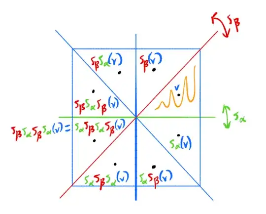

How are you describing the elements of these Weyl groups? Take $B_2$. I've drawn the standard picture below. I've picked a couple of simple reflections, $s_\alpha$ and $s_\beta$. They bound the fundamental Weyl chamber, which contains the point $v$. (Ok, I've added a square since I think of this group as symmetries of a square, but you can delete the square if you want.) I've applied the simple reflections $s_\alpha, s_\beta$ to $v$ in all possible ways, recording the shortest expression(s) for each point in the orbit. We can just read off that there is a unique longest expression, $s_\alpha s_\beta s_\alpha s_\beta(v) = s_\beta s_\alpha s_\beta s_\alpha(v)$. This is hence the longest element.
B2
    Thank you, this is exactly what I was looking for. I have a bunch of questions though: 1) why do the simple reflections $s_{\alpha}$ and $s_{\beta}$ bound the fundamental Weyl chamber? 2) Is it important to choose the fundamental chamber as a starting point? – cip Dec 29 '20 at 07:47
  • The reflecting hyperplanes bound the fundamental Weyl chamber by definition. The root $\alpha$ is along the positive y-axis here since the fundamental chamber is above the green line, and likewise the root $\beta$ is pointing southeast. 2) It depends on what you mean. You can choose different simple roots and thereby make any chamber the fundamental one. The key fact is the Weyl group acts transitively and faithfully on the Weyl chambers, so the Weyl group is encoded in its action on the orbit of any point in such a chamber--that's what I drew.
