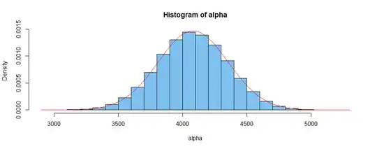

Comment: You can get a reasonable approximation to $Var(\alpha)$ by simulation. In the simulation, I assume the 51 numbers are selected without replacement.

A histogram of the simulated values of $\alpha$ looks approximately normal, so I show the best-fitting normal density along wit the histogram.
hist(alpha, prob=T, col="skyblue2")
 curve(dnorm(x, mean(alpha), sd(alpha)), add=T, col="red")
