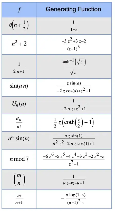

Differential equation are special cases of limit of a difference quotient over time solely. Difference equation are part of the theory of generating functions GeneratingFunction. There are differential equation for generating functions, GeneratingFunction, and difference equations. Both define the generating function complete.
Most generating functions are rational polynoms or transcendential functions.
table of function and generating function

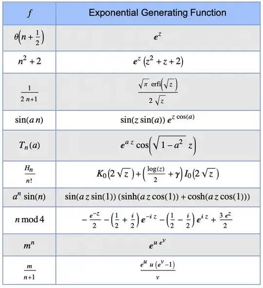

There are too exponential generating functions:
Both are mathematics but very different in nature. Do not mix them up.

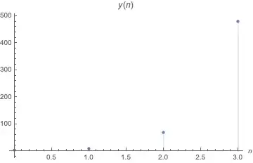

    sol = RSolve[{y[n + 2] - 7 y[n + 1] + n y[n] == 0, y[0] == 5, y1 == 10}, y, n]
give a solution in Mathematica. With f there is non.
solution
This is very rapidly increasing.

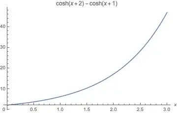

function plot cosh(+2)−cosh(+1)
This shows the homogeneous function diverges much faster than the inhomogenity does and is pausible that this might be an error in question.
