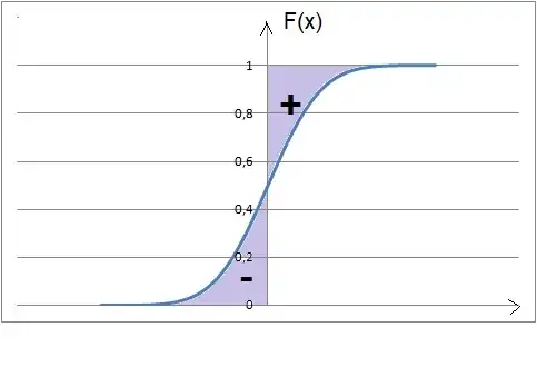

Graphically, the expectation is the difference of the following areas
Thus you are all set!
