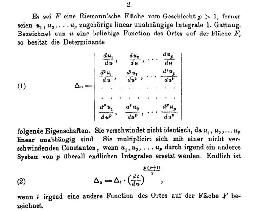

The earliest reference I could find for this identity is a paper of Hurwitz from 1892 titled Über algebraische Gebilde mit eindeutigen Transformationen in sich, which can be found here. Here's a screenshot of the Wronskian identity appearing on page 407 of the paper:
Note: I'll try to translate this if I have some time, but my German is very poor. If anybody has some free time and can do better than Google Translate, they are very welcome to do so!
In formula (2), the expressions $\Delta_u$ and $\Delta_t$ are the Wronskian of holomorphic functions $u_1, \ldots, u_p$ expressed in two different complex coordinates $u$ and $t$ on a Riemann surface. The coordinates are related by a change-of-coordinates map $t = g(u)$ and the notation $\frac{dt}{du}$ means $g'(u)$.
Notice that this formula is not quite the same as the one you wrote: the exponent is $n(n+1)/2$ instead of $n(n-1)/2$. Notice also that the definition of the Wronskian seems odd: the first row has the derivatives of the functions instead of the functions themselves!
This is because Hurwitz is not taking the Wronskian of the functions $u_i$, but rather of the one-forms $du_i = \frac{du_i}{dz} dz$. By definition, the Wronskian of one-forms is obtained by plugging their coordinate functions inside the usual Wronskian, whence the formula. This also explains the different exponent: one-forms do not transform the same way as functions under changes of coordinates and so the Wronskian picks up an extra factor of the derivative when changing coordinates.
