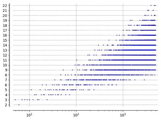

Here's a semi-logarithmic plot of the maximum number of iterations required for a given $p$, with $p$ ranging from 5 to 5000, checking all $2 \le n < p-1$. Both the best & worst cases do seem to be growing logarithmically.
max iterations plot

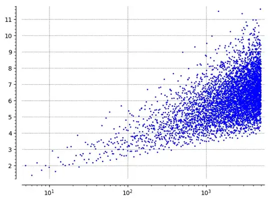

And here's a plot of the mean number of iterations, for $1 \le n < p$.
mean iterations plot
These plots were produced using Sage / Python. You can play with an online interactive version here (the script is actually encoded in the URL, not stored on the server). If you set the 'hi' parameter too high, the server will probably time out.
