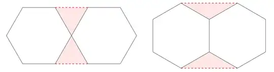

It's easy to see that a circle forces $A=\frac{4-\pi}{\pi}\approx 0.2732$. I believe that a hexagon yields $A=1/3$, as realized by either of these configurations:
two hexagon configurations

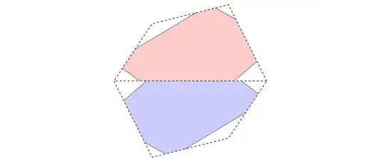

By a 1973 result of G. D. Chakerian (PDF link), we know that any convex set $S$ of unit area is contained in a convex quadrilateral of area at most $\sqrt{2}$. It is easy to see that in any convex quadrilateral, there is a side with two adjacent angles whose sum is at most $180$ degrees. (In fact, there are always at least two such sides.)
Then, by taking this quadrilateral and its $180^\circ$ rotation about the midpoint of such a side, we obtain a convex set of area $2\sqrt{2}$ containing two disjoint copies of $S$. So the excess area of the two copies in this configuration is at most $2\sqrt{2}-2\approx 0.8284$.
It is conjectured by W. Kuperberg that the minimal quadrilateral can have area at most $\frac{3}{\sqrt{5}}$, attained by the regular pentagon; if so, this would reduce the bound to $\frac{6}{\sqrt{5}}-2\approx 0.6833$.
I suspect that at least in the $\sqrt{2}$ case, one may be able to refine this result slightly and show that any convex shape taking up at least $\frac1{\sqrt{2}}-\epsilon$ of the quadrilateral can be packed more efficiently somehow, but my attempts thus far haven't proven fruitful.
