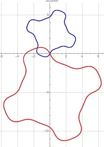

However differential equation of contour for pieces to fit together in a jigsaw puzzle is a more important and different tiling problem.
Not a JigSaw Piece
