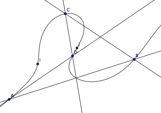

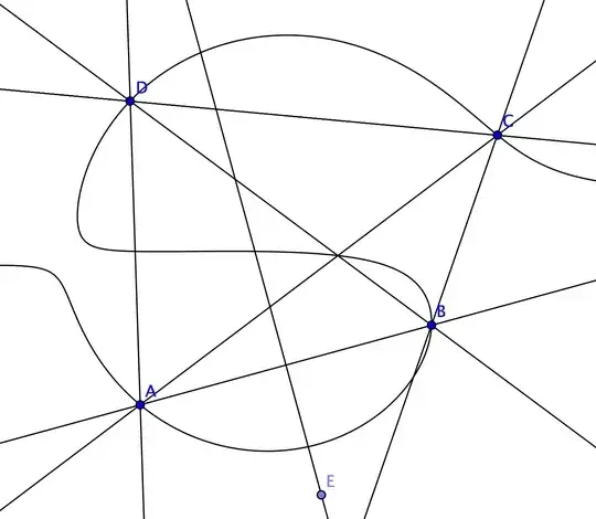

For a "formula" we would first have to discuss what constitutes an answer, but I made a picture to make it clear that the condition "inside" is not a very natural one.
I used geogebra. Note that when the curve crosses the line CD or AB , you do not have equal angles anymore, instead the smaller angles sum to 180 degrees, but it is fine again when the curve crosses again.
Furthermore, note that if you move the vertex A slightly, the part of the curve that passes through $A$ and $B$ becomes detached and formes a little oval curve.
If you want to see an equation: $$\frac{((a1 - x) (b1 - x) + (a2 - y) (b2 - y))}{\sqrt{((a1 - x)^2 + (a2 - y)^2) ((b1 - x)^2 + (b2 - y)^2)}} = \frac{((c1 - x) (d1 - x) + (c2 - y) (d2 - y))}{\sqrt{((c1 - x)^2 + (c2 - y)^2) ((d1 - x)^2 + (d2 - y)^2)}}$$
It does not get better if you square it.
Non-convex quadrilaterals do not look different, they also can pass from an S-curve to a little oval plus another branch.

  • @user9325, what feature of geogebra did you use to draw that curve? – I. J. Kennedy May 10 '11 at 20:19
    @I.J. Kennedy: Geogebra has a function that draws the locus of points when a certain point moves along a line. In my first picture you can see the point $E$ that moves along the bisector of $AB$. $E$ was the center of a circle through $A$ and then I drew a circle with corresponding angles through $CD$, then I defined the intersection of the two circles as $I,J$ and let geogebra draw the locus of $I,J$ when $E$ moves along the bisector. – Phira May 10 '11 at 20:43
  • @user9325: Very nice, thank you. I don't understand how the case of ABCD being a rectangle is a special case of your curve ? in this case, the points x are a line and they do not passe through the points A,B,C,D. – user3749 May 10 '11 at 23:38
  • @user9325: Thank you for the formula. If you have time, please put how you obtained it. – user3749 May 10 '11 at 23:41
  • @user3749 The curve does pass through A,B,C,D. You have one branch that is a horizontal line and the circle through the four vertices. Now if you wiggle the vertices a bit the intersections of circle and line break up to form an S curve. – Phira May 10 '11 at 23:43
