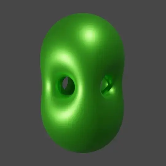

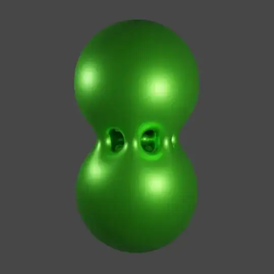

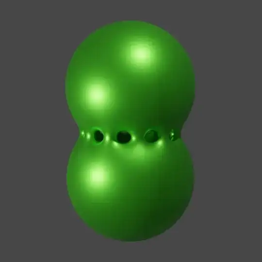

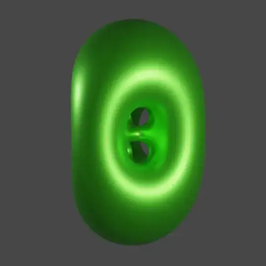

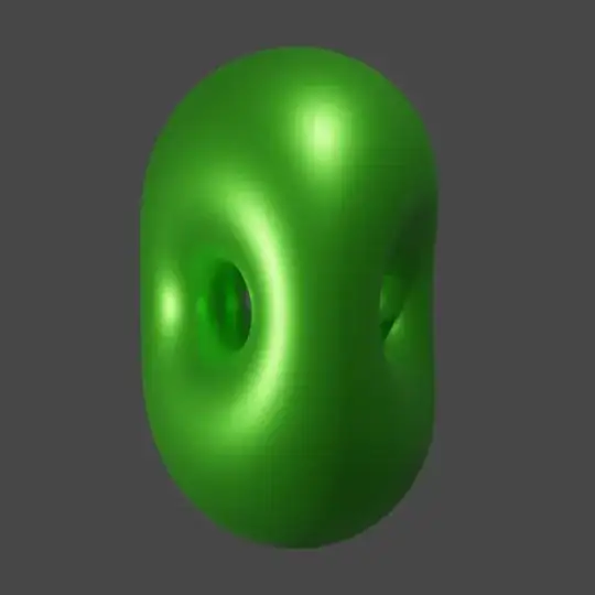

2023 edit: Lawson's original paper clarifies some things. In four dimensions $\xi_{m,k}$'s fundamental domain's boundary comprises four geodesic arcs connecting $\left(\cos\frac\pi{2(m+1)},\pm\sin\frac\pi{2(m+1)},0,0\right)$ and $\left(0,0,\pm\sin\frac\pi{2(k+1)},\cos\frac\pi{2(k+1)}\right)$. The arcs become circles passing through antipodes of the unit $2$-sphere upon stereographic projection to three dimensions, and by symmetry we only need a quarter of the domain. Surface Evolver with a custom surface energy integrand $(1+r^2)^{-2}$ (so that the integral gives the four-dimensional area up to a constant) followed by postprocessing transformations finally allowed me to render accurate $\xi_{m,k}$ surfaces for arbitrary $m,k$:
(m,k) = (2,1), 3-fold symmetry, simplest interesting case
(3,1), 4-fold symmetry
(10,1), 11-fold symmetry
(2,2)
(6,2)
