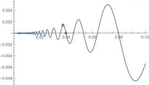

Suppose the derivative were defined as $$ f^\dagger(x) = \lim_{y,z \to x} \frac{f(y) - f(z)}{y-z} ,$$ then $f(x) = x^2 \sin(\frac1x)$ wouldn't be differentiable at $x = 0$. That is, you could find a sequence of points $y_n,z_n \to 0$ such that the slope between these points oscillates. You could do this, for example, by making the distance between $x_n$ and $y_n$ much smaller than the distance between $x_n$ and $0$. I think this definition would have been very reasonable, but that wasn't the one they chose.
I think this picture illustrated what is happening. See that there is a sequence of points going to zero such that the slope between those points is definitely not close to 0. But the derivative at 0 definitely is zero.
Picture of x^2 sin(1/x) with two points highlighted
  • Thanks Stephen the diagram helps a lot. So the $x^2$ term sort of imparts a "minimum" at $x=0$ despite the fact that the frequency of the oscillations is increasing. In a different scenario, what if we're just given the equation $g(x) = -\cos(\frac{1}{x})+2x \sin(\frac{1}{x})$. How might I go about calculating that $g(0) = 0$? – androyd Aug 25 '20 at 01:28
