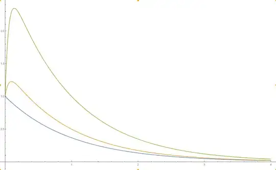

Let us now turn to the problem you have presented. The equation $x'+x=0$, subject to $x(0)=1$ has solution $x(t)=e^{-t}$. Whereas the equation $\epsilon x'' +x' +x=0$, $\epsilon \ll 1$, subject to $x(0)=1$ has general solution $$x(t)=Ae^{\frac{-1+\sqrt{1-4\epsilon}}{2\epsilon}t}+(1-A)e^{\frac{-1-\sqrt{1-4\epsilon}}{2\epsilon}t}.$$ Which clearly highlights the singular behaviour as $\epsilon\to 0$. But, as you pointed out, it appears this solution has no relation to $e^{-t}$ even as $\epsilon$ gets very small. However, their plots paint a different picture - all given for $\epsilon=0.05$.
graph
The blue plot is $e^{-t}$, the yellow is $x(t):x(1)=0.5$, the green is $x(t):x(1)=1$. It is clear that there is singular behavior at $t=0$, which is to be expected, but that the plots all approach $e^{-t}$. While you are right that we can always choose an $A$ such that the function is arbitrarily far away from $e^{-t}$ - this is due to the singular behavior at $t=0$ as $\epsilon\to 0$ - they will all approach $e^{-t}$ asymptotically.

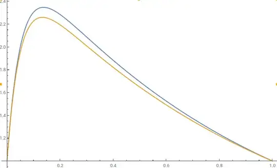

Letting $\epsilon=0.05$ here are the plots of the exact solution (blue), and the matched asymptotic solution (yellow).
It is quite clear that the asymptotic solution is a good approximation for small and large $t$, but leaves a lot to be desired in between. We would require higher order asymptotic expansions to get a good approximation in this region.

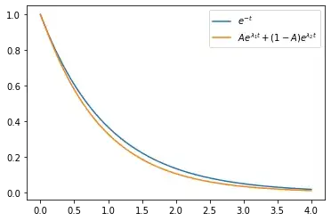

If we now plot these curves we see that these do in fact resemble $e^{-t}$ even for relatively large values of $\epsilon$. The following graph shows $\epsilon=0.1$
Graph of e^{-e} and perturbed soltion

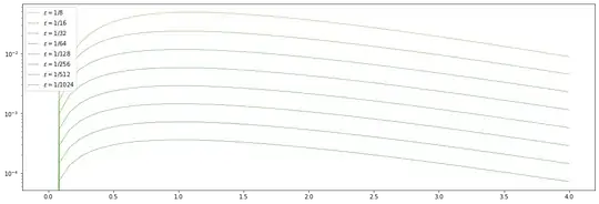

This correspondence gets better with smaller epsilon as we might expect. It is easier to see this if we look at the log-x vs t graph
graph of perturbed solutions in log-x

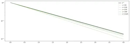

We can see this is getting closer and closer to $e^{-t}$ by graphing the difference (again in log format):
graph of difference in solutions in log-x
