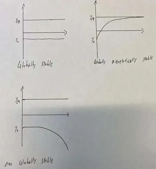

I have the same confusion about Globally stable and Globally asymptotically stable. I think this is because Globally stable does not have a clearly strictly mathematical definition, while Global asymptotic stability does have. (I search through the whole internet and cannot find the exact definition of Global stability. I will be very grateful if someone can provide it)
I am going to give my understanding of Globally stable and Globally asymptotically stable.
  1. Globally stable: A trajectory with an arbitrary initial point in the domain will remain a fixed distance from the equilibrium point. Formally, $y_{eq}$ is global stability if for any trajectory $y(t)$ with an initial point $y_0$, there always exists an $\epsilon >0$, such that $$y(t) \in B_\epsilon(y_{eq}) \quad \forall t\geq0$$
  2. Globally asymptotically stable: A trajectory with an arbitrary initial point in the domain will be additionally going toward the equilibrium point. Formally, $y_{eq}$ is globally stably if for any trajectory $y(t)$ with an initial point $y_0$, it satisfies $$\lim_{t \to \infty} y(t) = y_{eq}$$
There is a picture I drew to help illustrate the difference between non Globally stable, Globally stable, and Globally asymptotically stable.non Globally stable, Globally stable, and Globally asymptotically stable
Again, This is just my understanding, and I can't guarantee it is 100% correct, but it looks perfect to me for all my cases. Any comment or suggestion considering this post is welcome.
