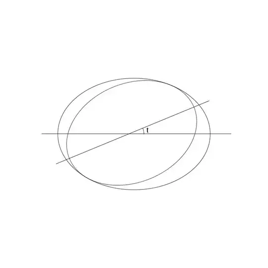

Let’s say I have an ellipse with horizontal axis $a$ and vertical axis $b$, centered at $(0,0)$.
I want to compute $a’$ and $b’$ of a smaller ellipse centered at $(0,0)$, with the axes rotated by some angle $t$, tangent to the bigger ellipse and $\frac{a’}{b’}=\frac{a}{b}$.

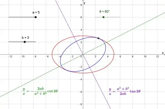

Let the oblique ellipse be
$$ \frac{x^2}{a^2}+ \frac{y^2}{b^2}-1=k \left( \frac{x\sin \theta}{a}- \frac{y\cos \theta}{b} \right)^2$$
which touches the standard ellipse at $(a\cos \theta,b\sin \theta)$.
This can be easily verified by plugging the point $(x',y')=(a\cos \theta,b\sin \theta)$ in the both ellipses and also have the same tangent line by referring to the useful fact in the very last of the post.

Using the result of another answer of mine, the angle of rotation is given by
\begin{align*} t &= \tan^{-1} \left( \frac{C-A}{B} \pm \frac{\sqrt{(A-C)^{2}+B^{2}}}{B} \: \right) \\ t_1 &= \tan^{-1} \left( -\frac{2ab}{a^2+b^2} \cot 2\theta \right) \tag{semi-axis $a$} \\ t_2 &= \tan^{-1} \left( \frac{a^2+b^2}{2ab} \tan 2\theta \right) \tag{semi-axis $b$} \end{align*}
In principle, $\theta$ can be solved in terms of $t$ explicitly. The work is tedious and verified experimentally by using Mathematica.

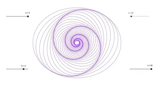

Further application
Illustration of spiral galaxy

mmh i don’t get it, what’s $t_1$ and $t_2$? and $\theta$? $t$ is given, i want to find $a’$ which is the horizontal axis of the smaller ellipse and in your response i don’t understand how to get it – donnoh Jul 30 '20 at 11:07
1$[\theta]$ is the point of contact. $t$ is the angle of rotation you mentioned. There're two principal axes so $t_1$ is the angle rotated by the major axis while $t_2$ is the angle rotated by the minor axis. The new semi-axes relate the eigenvalues for the matrix, that is $a'=\dfrac{1}{\sqrt{\lambda_1}}$ and $b'=\dfrac{1}{\sqrt{\lambda_2}}$. – Ng Chung Tak Jul 30 '20 at 11:19
1You can find $\theta$ explicitly in terms of $t$. My post has been greatly revised, pls have a look. – Ng Chung Tak Jul 31 '20 at 06:16

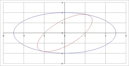

Applying this analysis to the ellipse
$ \dfrac{x^2}{5^2} + \dfrac{y^2}{2^2} = 1$
with $ t = \dfrac{\pi}{6} $, we get the following ellipse (I took the value of $\alpha$ that is less than $1$, the other value gives the ellipse that is tangent to the given ellipse but circumscribes it.).
